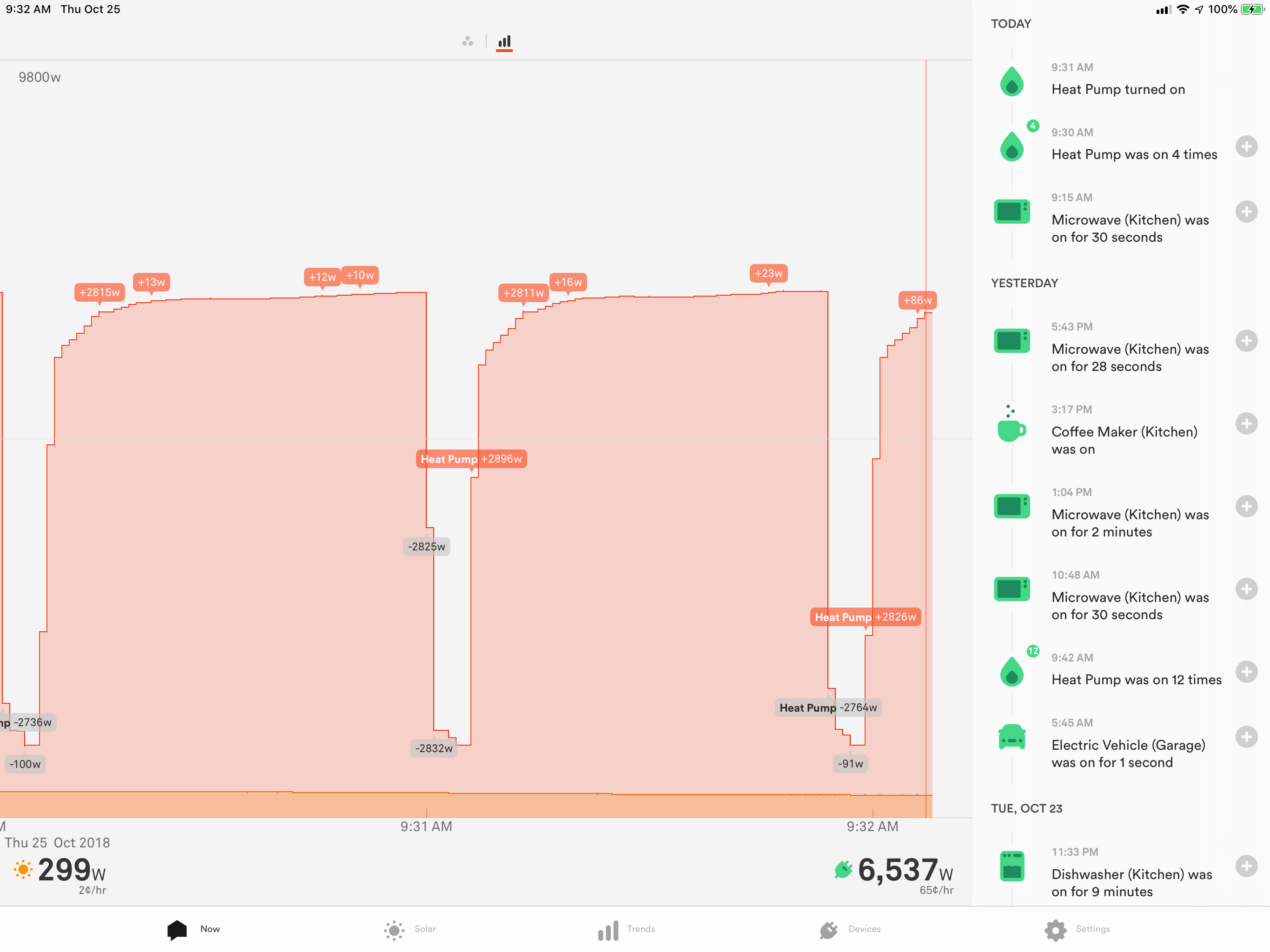

@RyanAtSense, I’m glad this is being looked into. Let me add to this discussion, as I’m having a similar issue. My heat pump is recognized by Sense, and shows up on the main meter and is tagged with “Heat Pump +2896W” (or so) on its way up to using 6kW or so, and tagged with “Heat Pump -2764W” (or so) on its way to cycling off (screenshot attached). So Sense is clearly recognizing it as a device using several kW. However, in the Devices view (and in the Bubbles), the Heat Pump consistently shows up as using only 2W when on, with the remaining several kW in Other. I reached out to support, but they (Tadhg) were befuddled by this behavior (but noticed some noise in my system and had me reset my clamps, which they said improved the noise).

Is this screenshot what your talking about? It happens very quickly and the spikes aren’t always caught by sense where the are visible every time on my timeline.i also can’t drag my timeline graph back and forth so that that spike will show in the wattage at bottom right.
