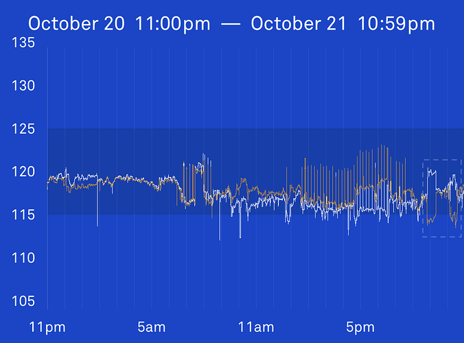

Does anyone have any thoughts on how to track down the root cause here? The fact that this is consistently an issue on L1 but rarely an issue on L2 makes me think that there’s an issue inside the house.

Do you have any device that presents a very heavy 120V load and is intermittently on an off. This big down spikes look like the possible startup of a motor. Assuming you have already checked Sense Labs for a floating neutral ?
Or you could have a 240 VAC device (like an A/C compressor) and one of the legs (L1) has a loose connection which requires a higher starting amperage. You would need to check all the electrical terminations. Re-tighten the lugs. Do you have any areas where there might be a possibility of Al (Aluminum) and Cu (Copper) wires being connected (spliced) together? You shouldn’t have Al/Cu splices, but people have done this in the past. Maybe the wires were improperly connected. Just thoughts…

I see some signs of a poor neutral connection in that voltage chart. What does the “floating neutral detection” section of Sense Labs say?

Hey @kelchm. We took a deeper look at this for you, and it looks like there’s a few things potentially going on. Grabbed a few screenshots for you, courtesy of Data Science.
Overall, we noticed some typical symptoms of a Power Supply issue - a potential neutral issue and some external interference. It’s also worth noting that right now, the Floating Neutral detector is a semi-manual process. The issues you’re seeing here that are indicative of a neutral issue would be flagged by the next update to the Floating Neutral detector, which you would be able to see in Sense Labs.
In the highlighted region in this image, you’ll see a 1000W load appears to be causing an inverse 3V dip, which could cause flickering of lights (and other symptoms you might have noticed). This is indicative of a neutral issue.
Above, you’ll notice a fluctuating voltage supply. Typically, this could be due to several reasons including:
  • An in-house appliance which is not monitored by Sense is causing the issue (which you ruled out with the answer to my original question).
  • Since there is no in-house load corresponding to the voltage fluctuations here, it leads us to believe there is an external issue (neighbor, lines feeding into the house) that could be causing irregularities here.

Still investigating this at this point. The data from last night seems to show pretty clear evidence of a neutral issue:

That said, I’ve identified an interesting pattern over the last week or so that has me completely baffled. While the timing isn’t exactly the same, there’s clearly some event happening on a daily basis in the range of 7PM-11PM.
Looks like a 240V (dual leg) device turning on with a weak/loose neutral somewhere as you suspect.
