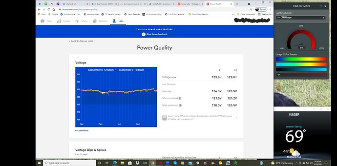

Andrewsimkins… Here is something you could try that should be very easy.
Go to your Sense… Tabs on top screen go to the ‘LABS’…Pick the ‘Power Quality’… See what you have for the Min / Max Voltages… This could get tell you something… Later…Gerry…
Send you a pic of the screen in a couple of minutes…
