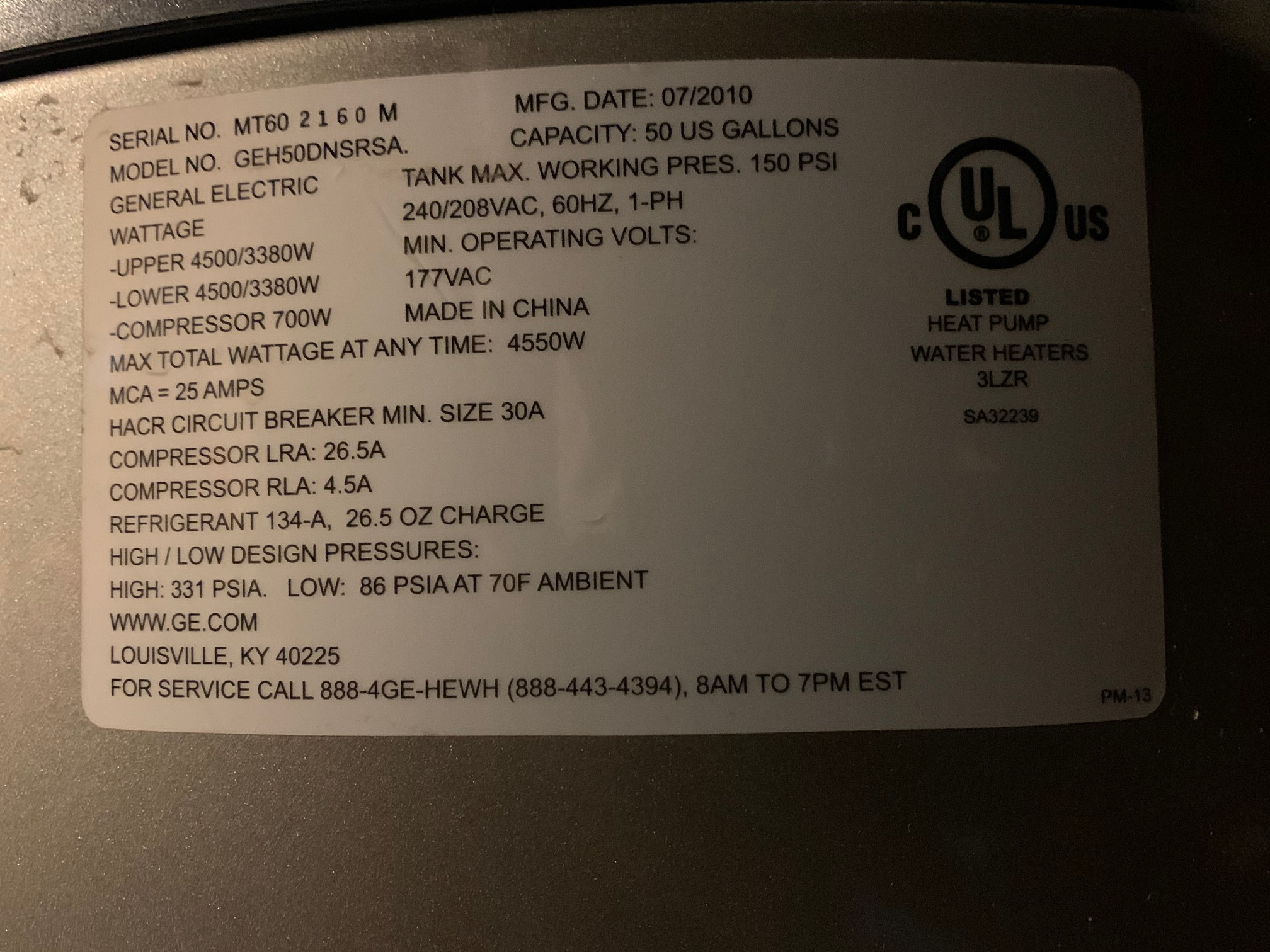

I snapped a picture of my hot water heater tag. I run it on heat pump only mode. The only time I had the elements on is when it leaked all it’s freon out, I temporarily changed it over to heating element only mode, until the technician could get out and service warranty covered repair at no charge. Default mode is to allow both element and heat pump to work, the elements only come on then when there is a long draw of hot water and it is taking to much time for the heat pump to get the water up to temp.

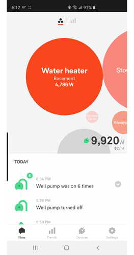

Bill… OK… That makes sense if … 110 volts on the compressor. 4.5 amps X 110 volts = 495 watts… Back 3 days or so you said [quote=“billparn, post:11, topic:9202”] 460 watts or so, now it has been showing 597 watts the last 3 times it has come on and ran. [/quote] … Something else running to bring it up to 597… looks right… Or whatever… compressor running on 220 volts at 4.5 amps would be around 1000 watts… All in all I do like the concept and maybe we’ll look at it again when it comes time to exchange the tank again… Also I attached a ( both legs hi hi ) pic of my heater. 4786 from Sense. My gen was showing 4750 and 5000 depending on element, I guess…
. So these 2 meters if you can trust them showing pretty close. Thanks for the pic… Later…Gerry

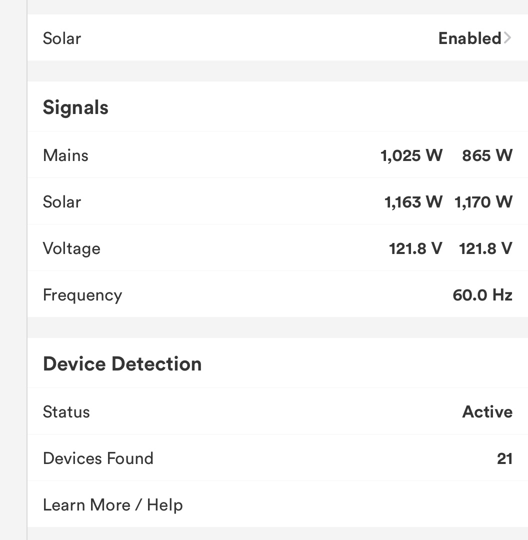

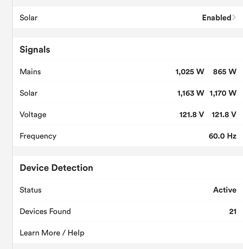

I see it using 597 watts now. My mains run closer to 121 volts when solar is on, 119 volts at night when solar is off. It is a cloudy today but solar is still working, attached is what sense is seeing on my mains…
So 120 x 4.5 = 540 watts and the the fans blowing on the evaporator may be the additional,watts.
I will to try and catch the mains to see if it is on just one leg, most likely it is…
OK… Bill Real fine… Next time I have my gen going I will take a pic. It shows either 4750 or 5000. Maybe a long while… Winter is setting in… Later…Gerry
