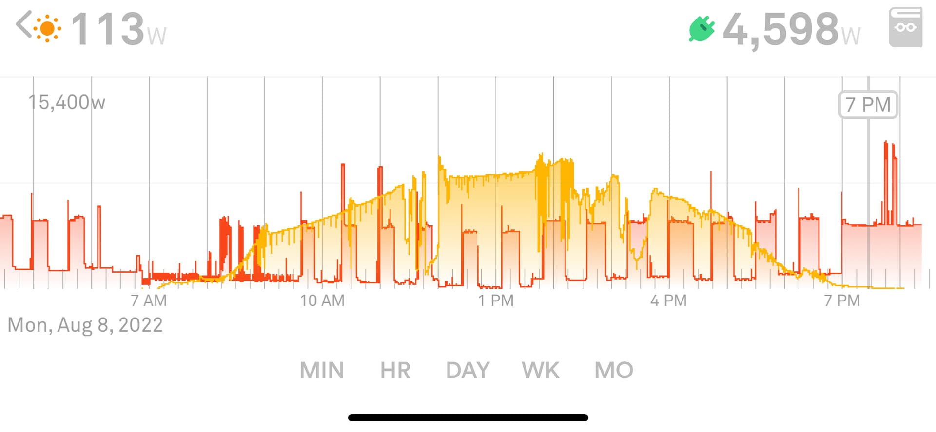

Here are today’s totals (so far) and some screen shots:
Thanks ! looking good.
Right now To Grid - From Grid = Net production, as expected. I’m interested in the same display for Aug 8th, but from tomorrow, after Sense has converted / closed the data to Yesterday.
I’ll post the totals for today, tomorrow.
Let’s hope everything adds up!
Here is the screen shot of the totals for yesterday:
Thanks. To Grid - From Grid = -13.3 while Net production is -9.8. I think this is a different variant of the issue you saw at the start of this topic (spurious extra load being added to From Grid), but I think it’s a relatively new issue with the solar summary that affects all solar users. I’m still investigating.
