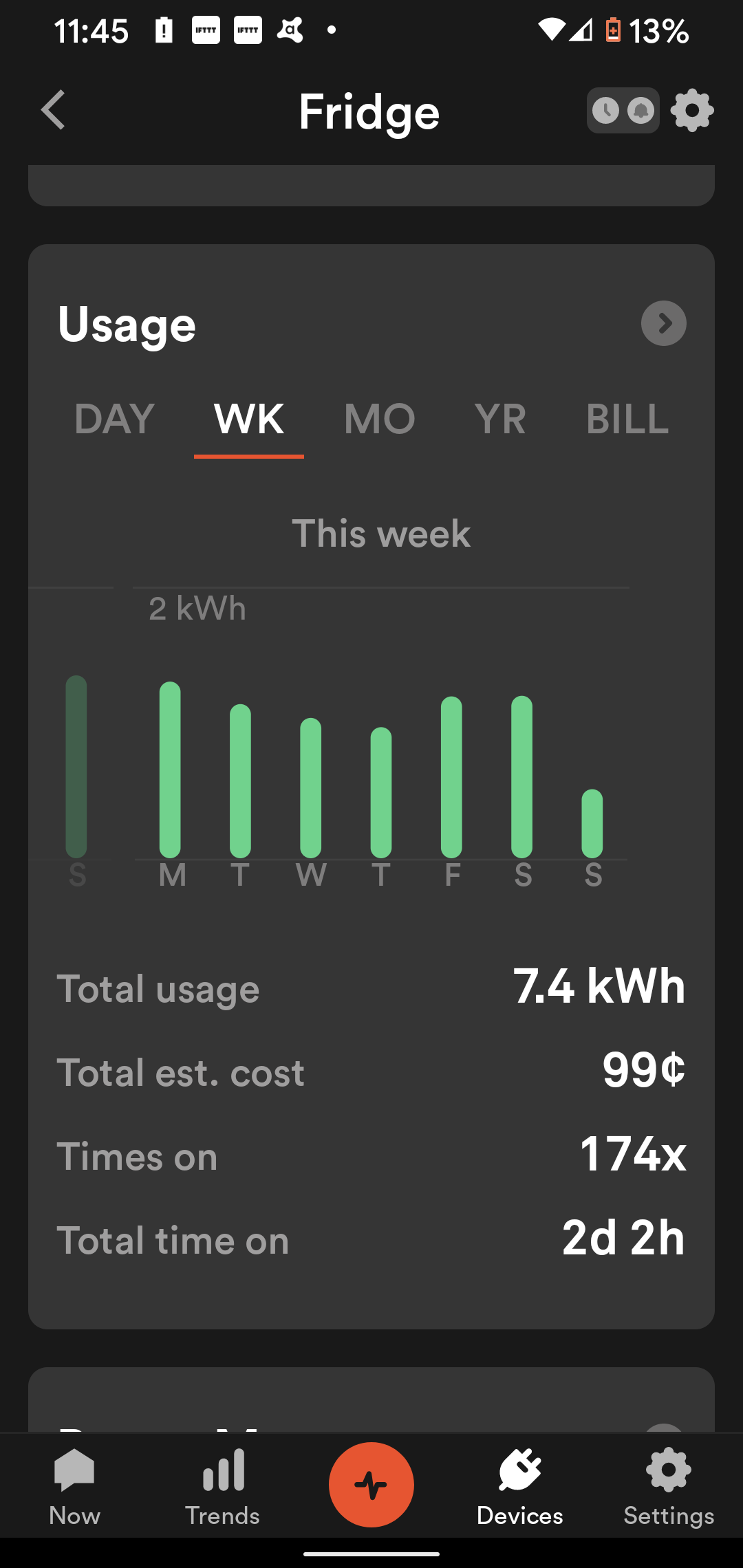

I have a little update with two screenshots. One is my HS 110 that my refrigerator is plugged into and the other is senses native detection on my refrigerator, sometimes the smart plug records more consumption ,sometimes less but it seems to e even out pretty close over the course of a week.
Impressively close. Looks like Sense has “found” your refrige device(s) quite successfully. Congratulations
It found it quite a ways back but I was never sure of it’s accuracy. I’ll probably leave it double reporting for another week then I might tank the hs110:and plug it in directly
Sorry but that’s not close at all…
The “Fridge” is missing 18 hours of on-time and still reporting more Usage.
The Smart Plug (which should really be considered a source of truth here) not only has 18 additional hours, but also less energy consumption, AND more Times On by almost double.
