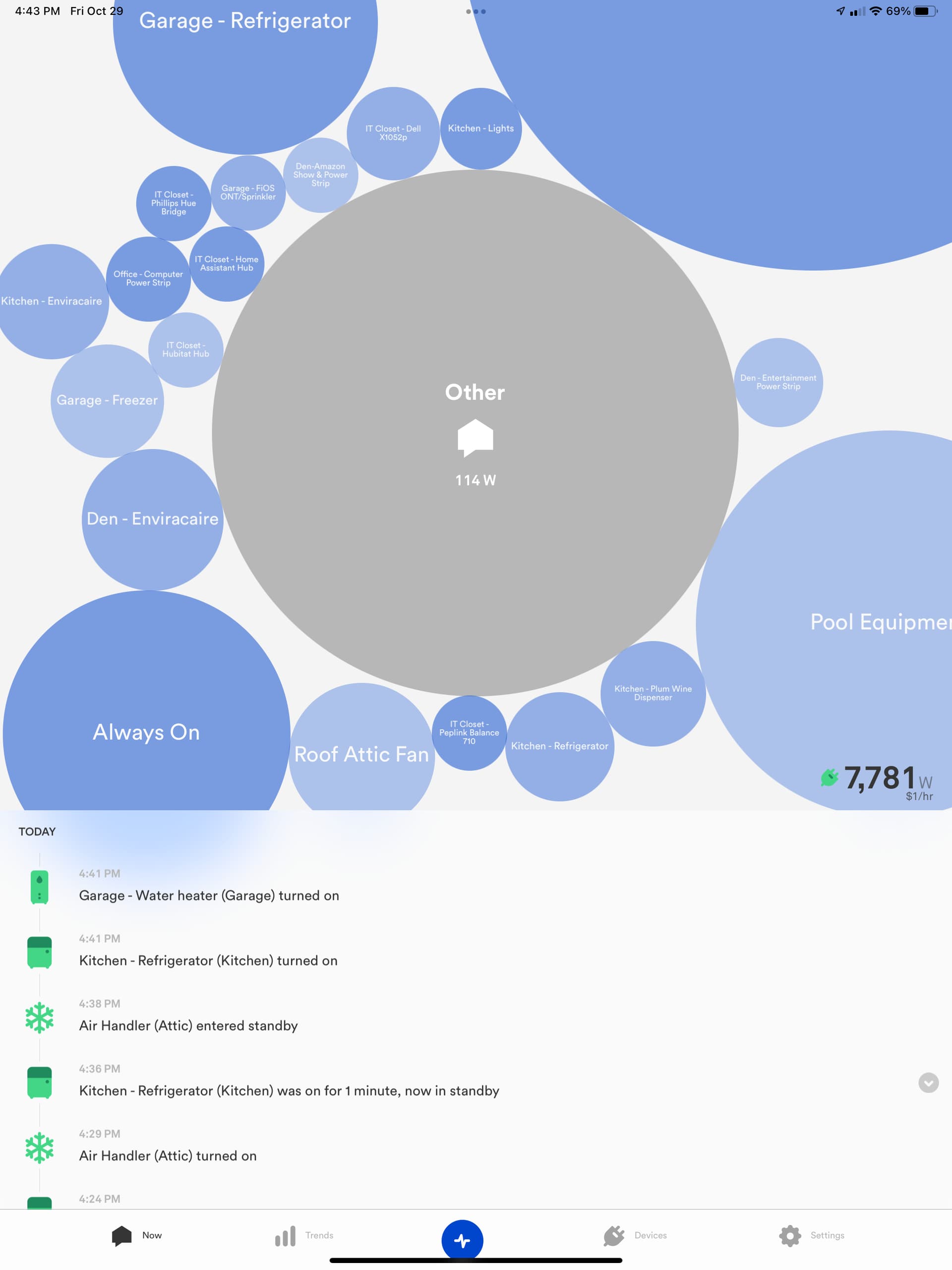

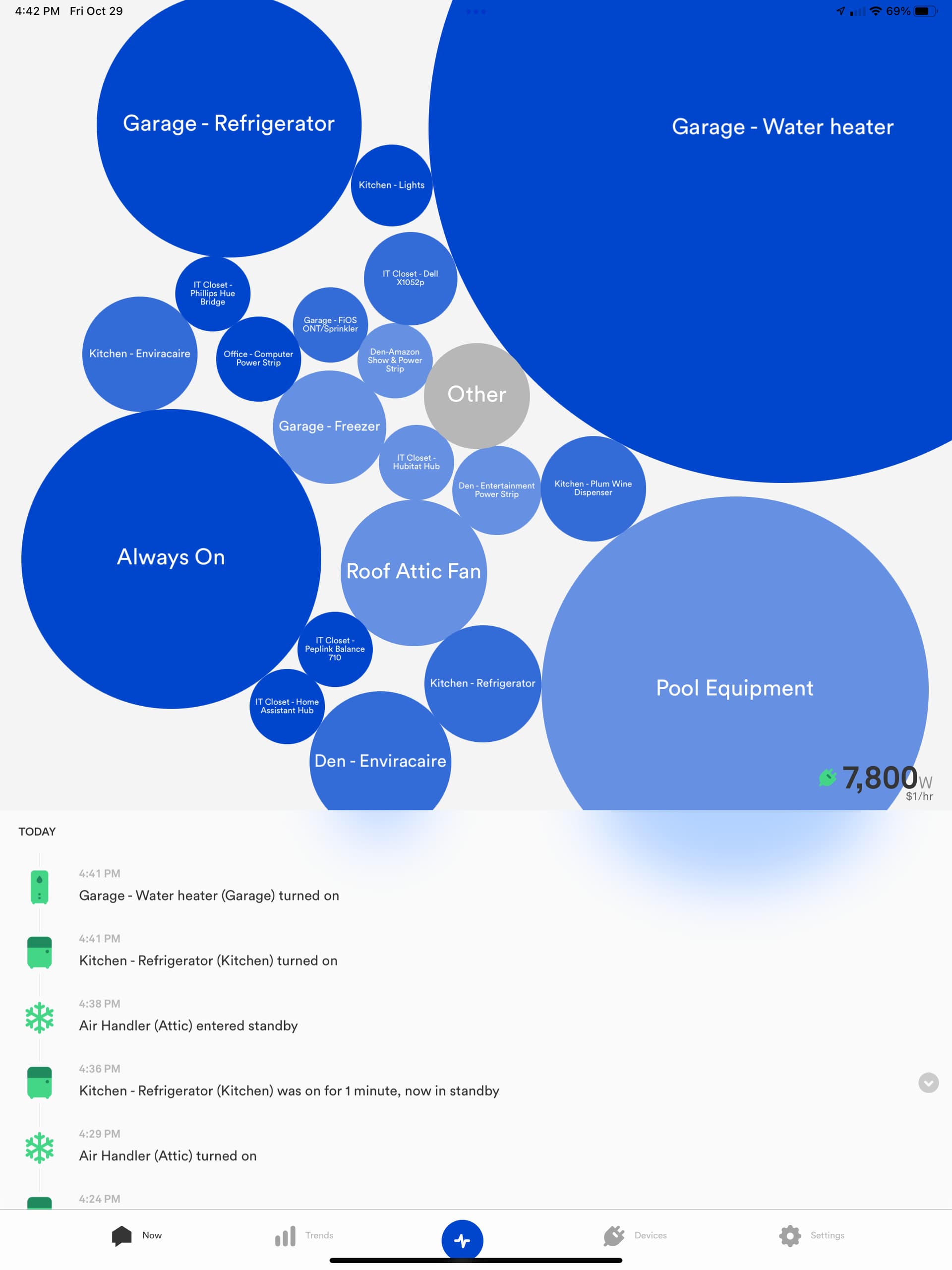

Seems like you are running at a pretty high detected device ratio - that’s a place where the double counting of Always On between the main Always On and smartplugs slice could help displace Other.
The lag time might be a result of progressive detection. As I understand it, there is a tradeoff between broader detection capabilities and lag in displaying on/off. In other words, one can detect more if Sense can looks at a little wider time window around transitions.

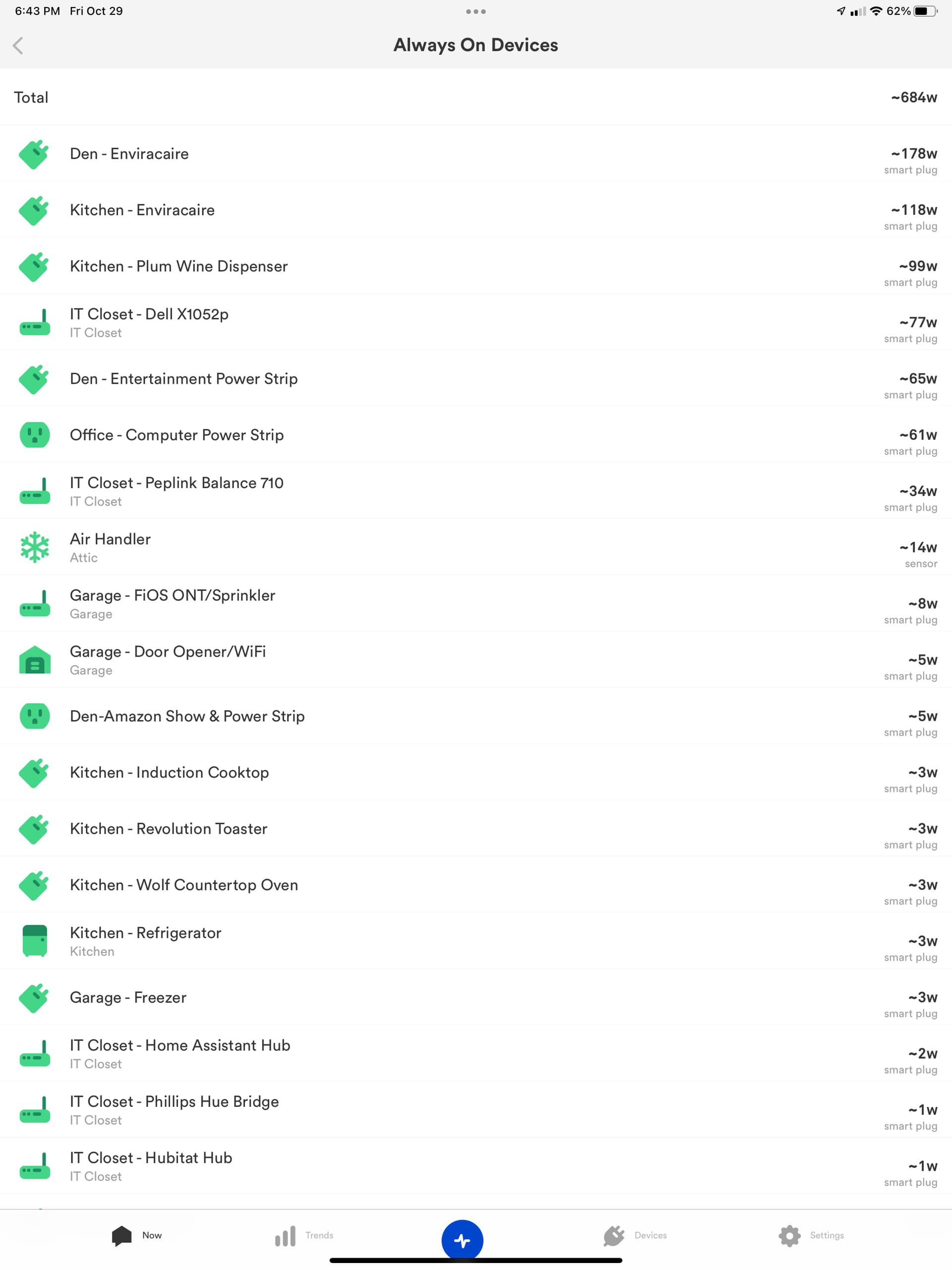

There’s really not a way to adjust the Always On bubble value to remove the Always On components picked up by the smart plugs. The accounting in the Always On device is mainly focused on figuring out how much of the Always On bubble is unknown.
If a smart plug has a big dynamic component and only a small Always On component, then you should just keep using it as is.
If a smart plug has mostly an Always On component (i.e. my switch that uses 38-39W continuously), then it might be worthwhile removing it from the smart plug and simply entering the Always On component in the Always On list.

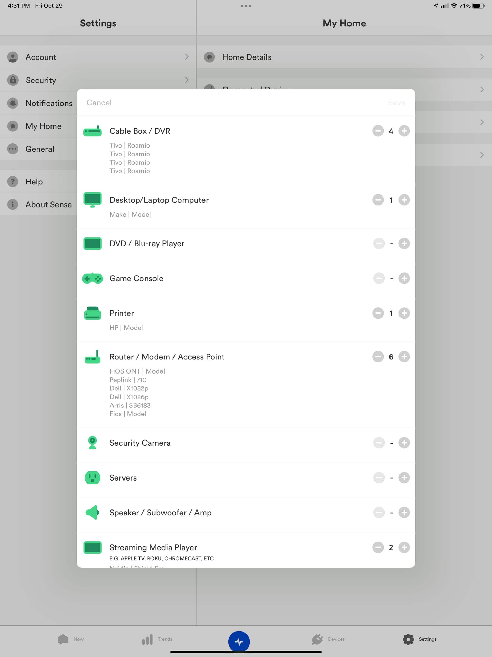

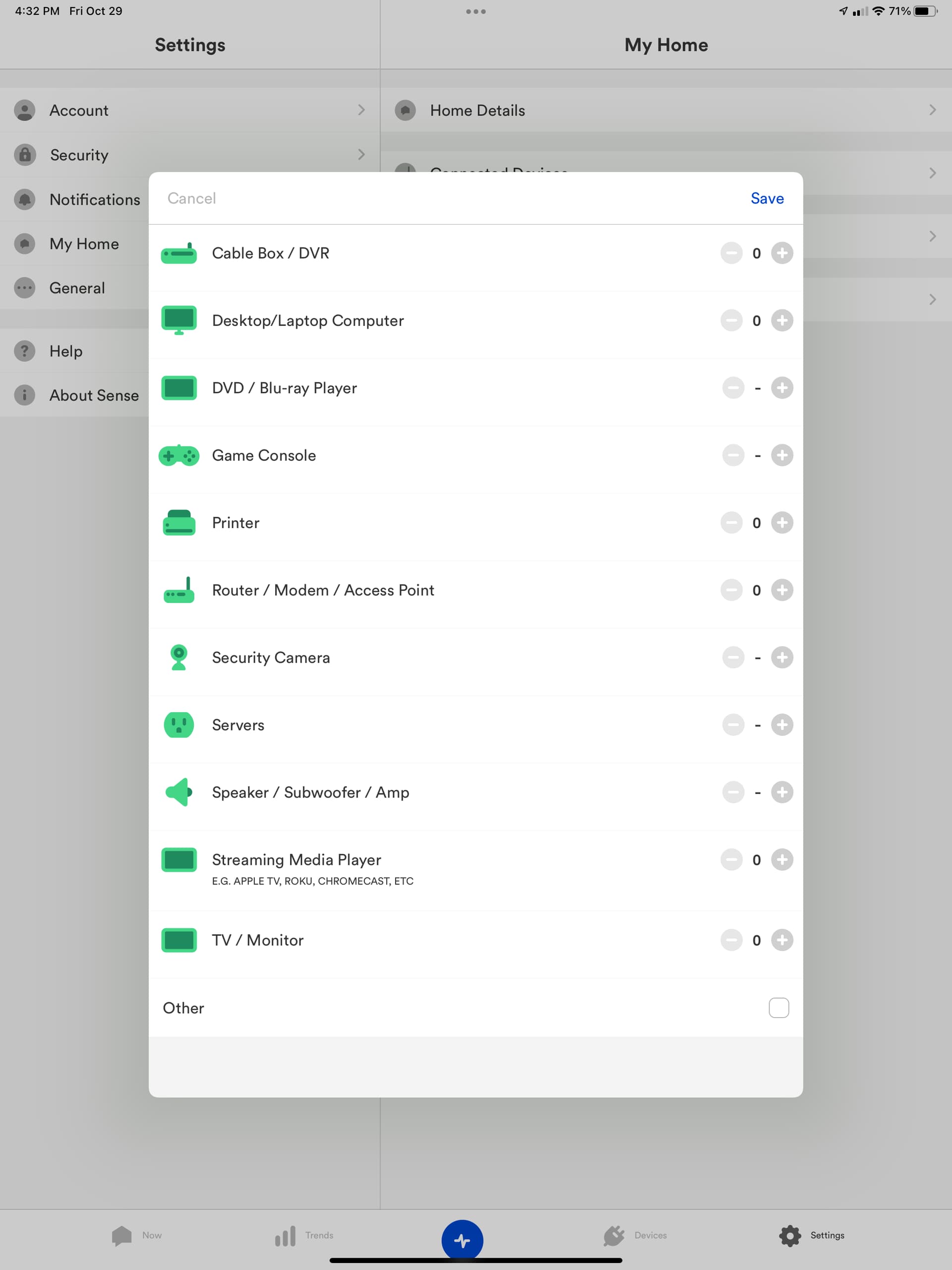

From what I understand about the Sense Home Inventory, it does NOT control any part of the operation or calculations in Sense. It solely does two things today.
Provides Sense with a survey and prioritization of devices that they need to model within their customer base.
Gives additional details about the devices in your home for the Similar Homes comparison.
So I’m doubtful that erasing devices in your Home Inventory was the reason for the re-emergence of other. But I would welcome any guidance from the Sense team to the contrary.
The place that I was describing is here, in the Always On list. In my case you can see that there are 205W of Always On that come from smart plugs or manually entered devices (using the “+”)
@kevin1 is correct here @Beachcomber. We’re looking at ways to improve the connection of device detection with home inventory but currently it only extends to what @kevin1 mentions above.
