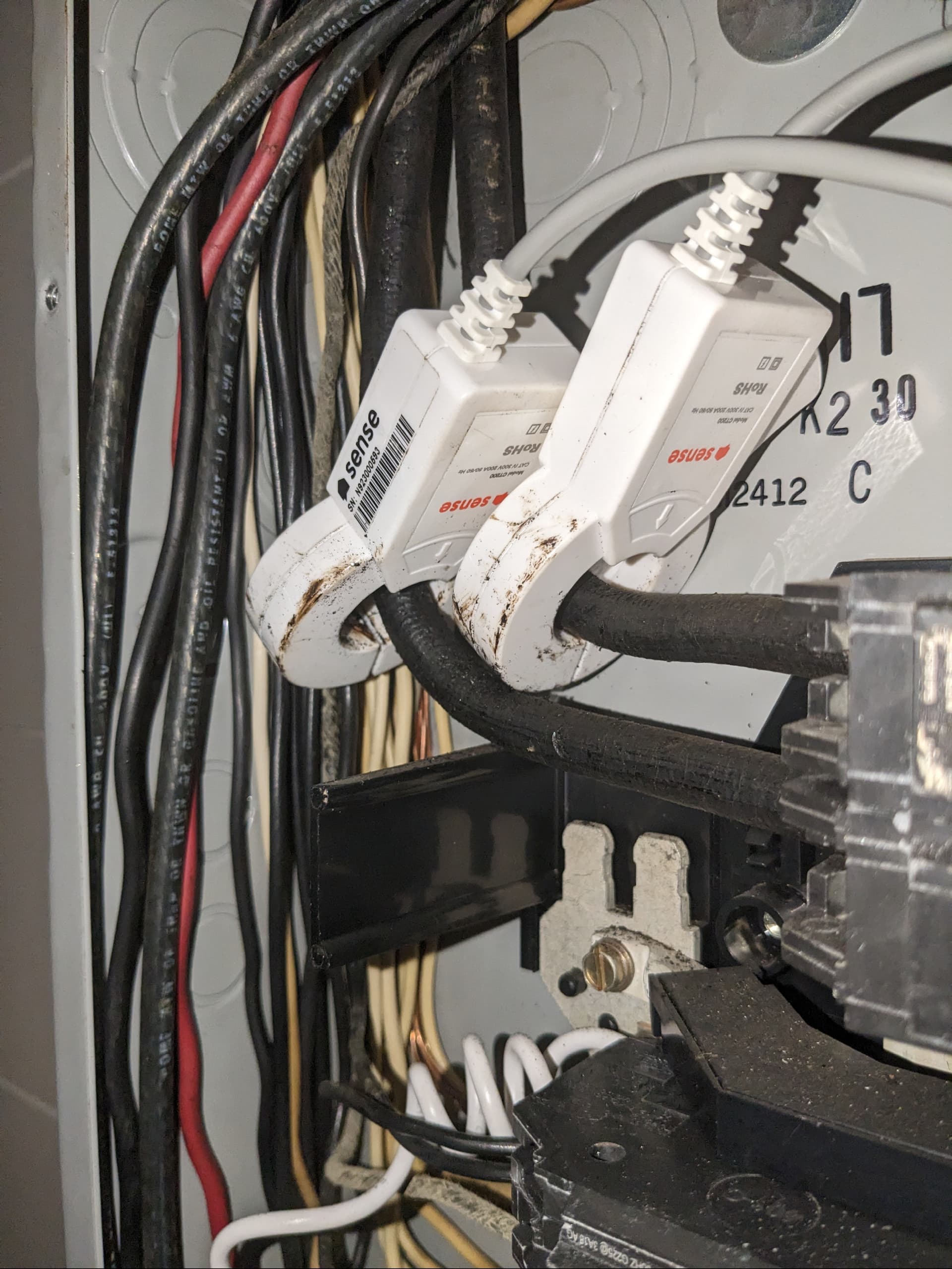

I have three months of Sense data to compare with my electric bill since moving into my first house. So far, there’s a huge descripancy. Average usage on my electric bill for the past three months has been 21, 19, then 21 kWh/day. Compare that to the average usage reported by my Sense meter over the same three months- 10.8, 10.6 and 11.7 kWh/day so far in May. Either my Sense is signicantly underreporting my usage, or Chicopee Electric Light is charging me for a lot more electricity than I’m using. Either way, I’d like to get to the bottom of it.
Welcome, @o498957 . Congratulations on having your own house! The big discrepancy you report is worth following up on. I suggest:
  • Make sure the CT clamps are tightly closed. CT clamps are the two crab-claw shaped donuts with wire leads which allow Sense to measure energy usage. If your CT clamps are not tightly closed, they take incorrect readings. Sometimes clamps can be jiggled open by the act of closing the electrical panel back up, even if they were closed when you last saw them with your eyes, so double check clearances if you are comfortable working inside your panel box.
  • Is there a sub-panel that is connected to your meter but not included in what the CT clamps measure? Some users post photographs of their panel box here to allow the community to diagnose issues, which is surprisingly effective. You’ll automatically be allowed to post images after a 3 day waiting period for new users, beginning with your first post on the forum.
@o498957 , I’m betting on one of the same two scenarios that @jefflayman is suggesting as the cause - either incompletely closed CT clamps(s) (sensors) or a hidden “secret” second subpanel or split mains bus. Both have been seen on the community forum before.
Both meters are fully clamped on the power mains. Checked clearance when covering the panel back up, does not appear to be interfering. The clamps look a bit dirty, but they’re definitely closed.
100% sure there’s no subpanel. I spent a day mapping the breakers to every light and outlet in my home with wireless circuit breaker finders, I can account for all breakers and corresponding lights/outlets on the main panel. Also paid for a comprehensive professional inspection before finalizing the home purchase, was present on the walkthrough, and spent most of it asking electrical questions, so if it existed, it would be identified.

  1. I helped my brother install his SENSE unit. For some unknown reason the past homeowner wired the HVAC directly to the outside meter. The only location to place the CT clamps so that he could measure all his power was above the meter on the incoming feeds. Check your outside installation and see if you have a similar issue where someone may have tapped the service cables before the breaker panel. You will need a professional electrician to install the CT clamps.
Could you post some pictures of your electric service as it enters and leaves the electric meter.
  1. I believe you when say that your CT clamps are fully closed, but if you want to make certain, then tape the ends closed. I used masking tape to ensure my clamps remained closed.
  2. You have two loose unterminated wires (a black and a red) on the left and 2 unterminated wires on the right (a black and a white) with copper showing. Please add a wire nut or tape the ends for safety. You do not want those wires coming in contact with any live part of the panel. This is a safety issue.
  3. I don’t think you have the space, but I found when I was able to center and place my CT clamps at a 90-degree angle to the incoming wires, that I got a slightly closer reading to the power company numbers. I documented my experience about 5 years ago in this forum.
The most detailed data from my electric company is for 30 day billing periods. I can check my meter every night at midnight to get daily totals, and theoretically could monitor over shorter time intervals to test under a specific, focused group of usage variables, cutting off power except for a small number of steady, known power loads to compare the meter and Sense data to the predicted usage. Would require some planning and precise execution on my end, but is doable.
Thanks for the tip on wire caps for those unterminated wires. They’re routed to an old 240v through the wall a/c that’s no longer in use. I freed up space by removing the breaker when I moved in, but neglected to cap the wire ends. Will do.
I believe the incorrect Sense monitor readings issue is solved. Sense support suggested that my monitor wasn’t getting solid wifi connection, and wifi dropouts were the cause. That was not the case. The router is about as close as possible, 15 feet max, it’s a decent router, Asus Rt-ac86u, and my wifi connection test in the app showed no issues, and I saw no time gaps in monitoring history. What worked for me was doing a data reset. Registering the Sense monitor from scratch, letting it complete initial tests, and immediately I can see a huge difference. While before, it was reporting 300-400 watts total with two window A/Cs running, the live data it’s reporting now with the same approximate electrical load appears to be right in the ballpark of where it should be, somewhere between 1000-1500 watts, and moreso when the dishwasher, washing machine and/or dryer is running. Don’t know why it was underreporting significantly before, but alls well that ends well, and seems to be reporting correctly now.
