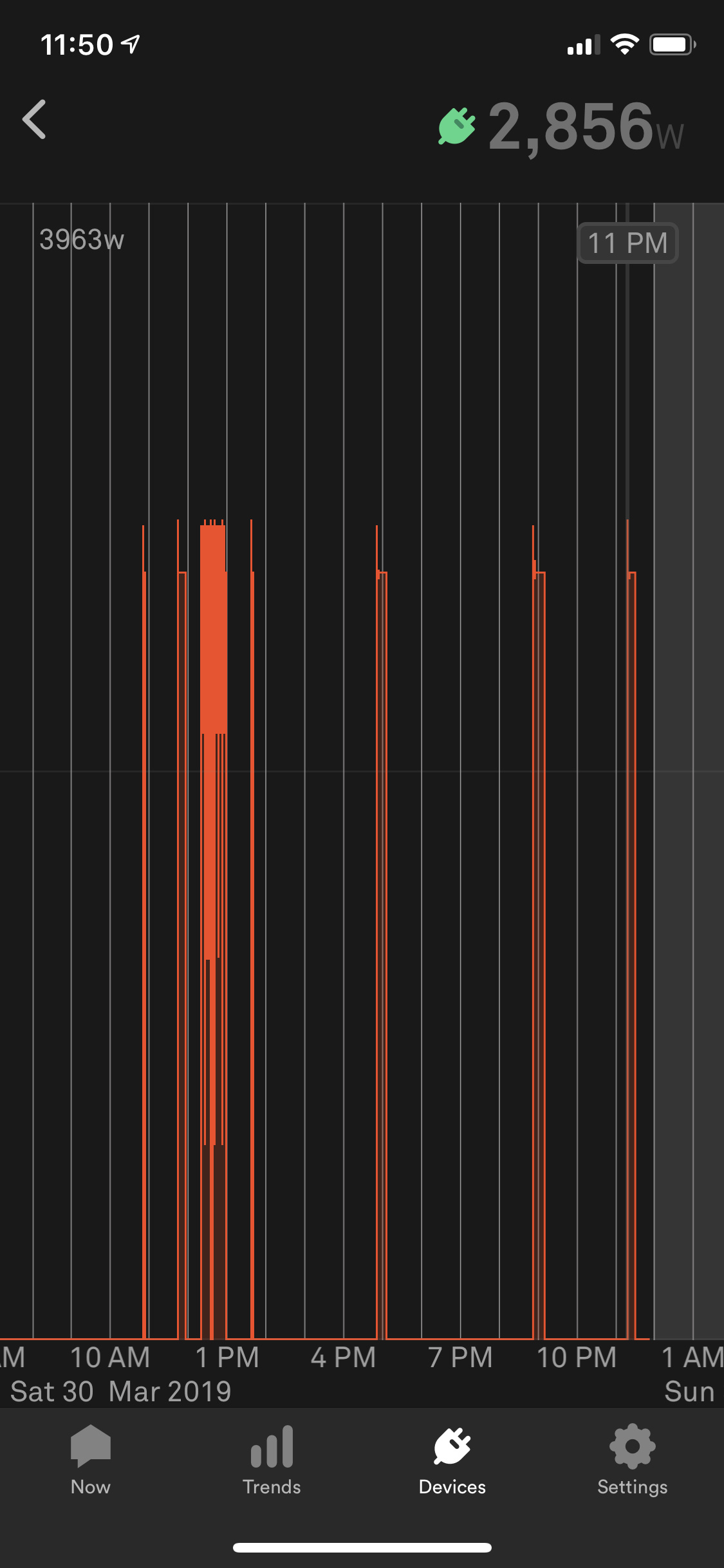

I’m at a loss and don’t know what to check. I have a 2600 unknown heat that I originally thought was my dryer. I turned on the dryer and it turned on.
However, now I see it come on (between 2600 and 2800 watts - kicks on at 2800 and then drops to 2600 for about 18 minutes) and I can’t find it or figure it out.

Also if you could take a screenshot of the signature of the waveform of a single cycle it would help identify as heat and motors and compressor s look very different. I can’t make out what the individual cycles are in you screenshot
But does appear like a compressor from what I can see

Can I see/screenshot a waveform when the device isn’t on?

You might get some insight (in general) by looking at the different legs of your panel feed. If the 2kW+ is coming from a multi-phase circuit then you’ll see it in Settings>Home>Sense Monitor>Mains when it’s actually running. You’ll have to look at it live. The load split is lost in the aggregated waveform that is just showing the total current x volts from both legs. Sometimes uneven load splits can be revealing. It’s unlikely, for example, that anything over 1,800W is on a single phase unless you have 20A or larger wiring/devices. Chances are you won’t learn much because the load will be evenly split but you never know.

So right now the dryer is off, the furnace is set to two degrees under the current temperature and isn’t running, the dishwasher isn’t running, the house is silent, but this unknown heat is at 5800 watts.
Looks like possibly a 5500 watt water heater
