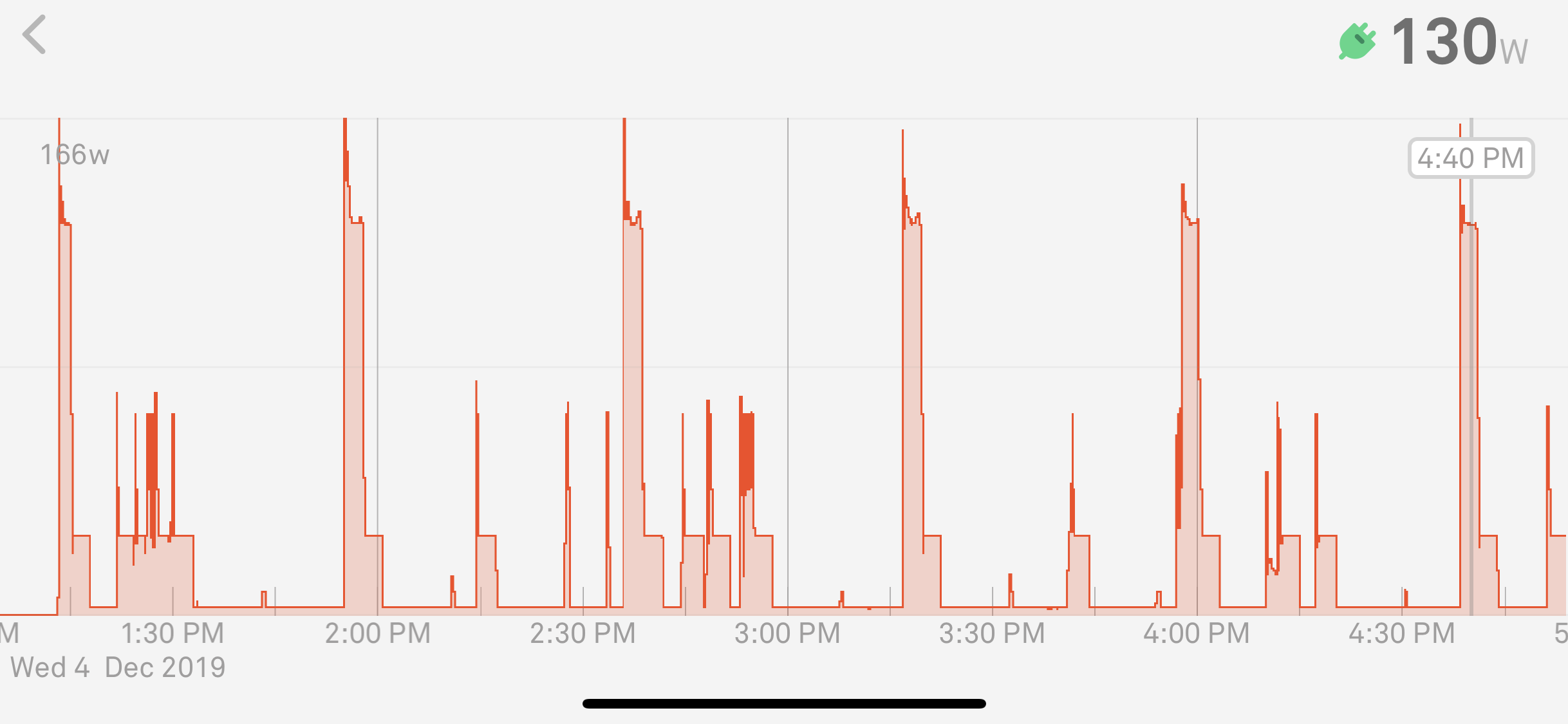

Here’s a comparison between recirc/electrical usage between traditional tank heater and a tankless Rinnai.
Tankless
Traditional
ps: Both are on timers as well so off during the late night.

Mine will probably never be detected now that it is on a smart-plug, because Sense tries to not re-detect something that’s already being monitored on smart-plug. I was impatient since I needed to see what the new usage pattern looked like. After seeing it (above) from smart-plug, it looks like it has multiple components (big spikes, little spikes and plateaus). Based on what I have seen from what Sense does detect on my furnace, Sense would probably only detect the big spike component.
