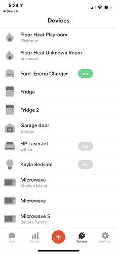

I just added to the survey. 6 of my stalwart HS110s that really haven’t given me any issues in months, suddenly turned into zombies tonight. One of them came back with a reconnect command, but the other 5 refused to come back to life:
The HP LaserJet plug was one of them - it showed up as n/a in Sense
None of the Zombies responded to pings. And they remained ping Zombies, even after power cycling the smart plug. FYI - all of my many smartplugs had DHCP assigned (non-fixed) IP addresses.
