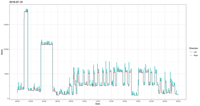

  • But before that, I have to make sense of the data which has 2 (or really 4 until I do the path to point reduction) power values for each time point. The way Sense displays the data, it does a right-ward sweep of data, then comes back with a left-going sweep via the path construct where the right going and left going sweeps, put down different power values for the same point in time.
For well behaved days, the numbers aren’t all so different and the left looks like a shadow of the right trace.

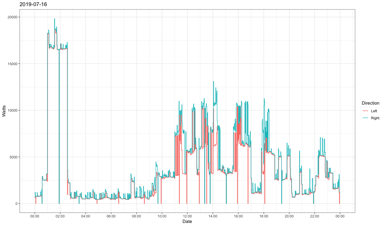

But other days, where there has been a data dropout or 3, I get less correspondence between the right and the left:
Any creative thoughts on the best way to resolve the two lines ??

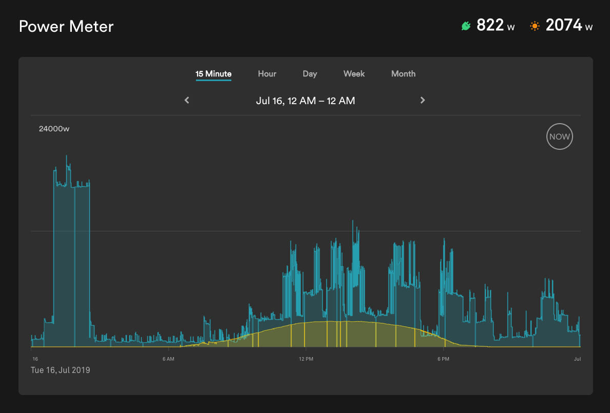

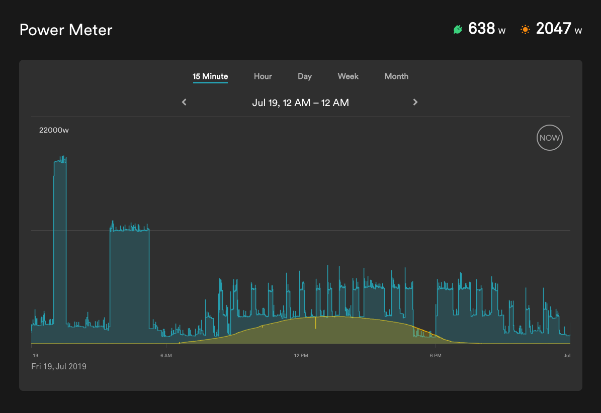

Matching Sense web app view below.
