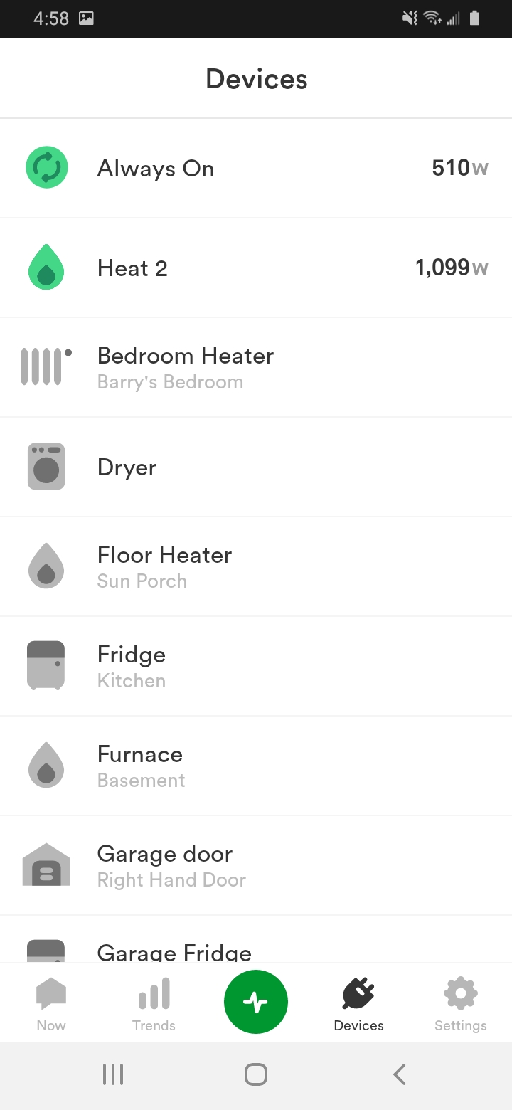

My Sense monitor identified a device and named it Heat 2 about a week ago. It was on very briefly. I turned on again last night. It reads 1099 watts. Have not been able to identify it. Any devices that would use that much wattage has been identified. It has been on for over 9 hours. I looking at the “Now” information it states I’m over using about 800 watts. The “Devices” screen states over 1600 watts. Why is there a difference? Screen shots attached.
The bubbles are estimates. If Sense misses the off signature of the device turning off, the bubble will show up. Tap the bubble to open the device, go to manage, report a problem, device is not on.

I followed your instructions and it no longer shows as on.

One likely sign of a missed off-detection is Total Usage (770W) being larger than the total of listed devices in the on list (1609W). Could also be caused by double counting of smartplugs (in your case no) or an Always On that is temporarily too big.
