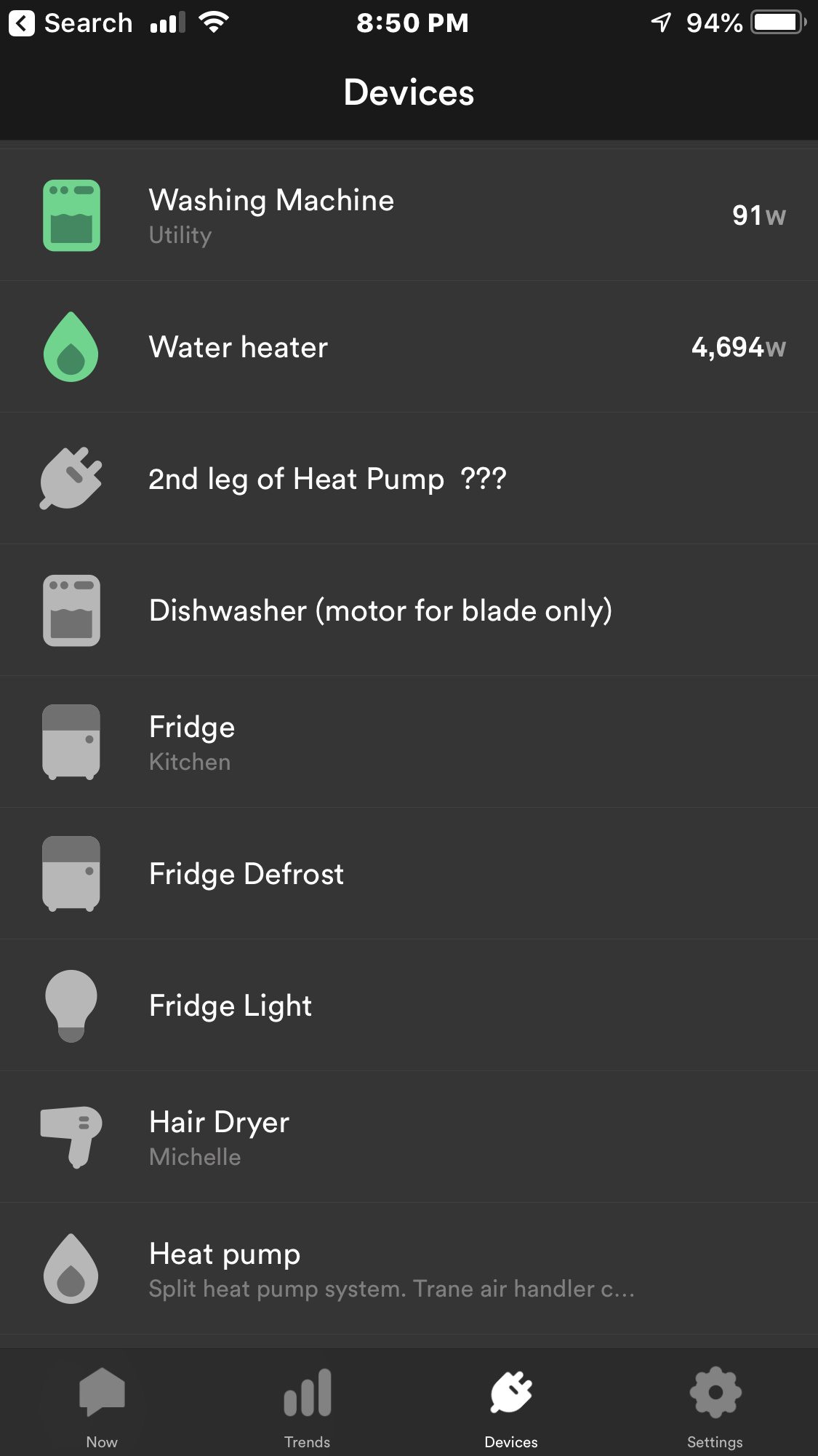

Be careful what you wish for with every component being detected in your fridge. I’ll use my fridge compressor, fridge defroster and fridge lights for this example. Those three have been detected on mine. But if they were to end up merged together then every time someone opened the door, it would say “fridge is on”. Oh, also the ice water dispenser is detected so it would be the same. Tones of fridge on and off notifications when it wasn’t the fridge actually running th compressor or fan for cooling purposes. I want these components detected separately for this reason so they are not merged together.

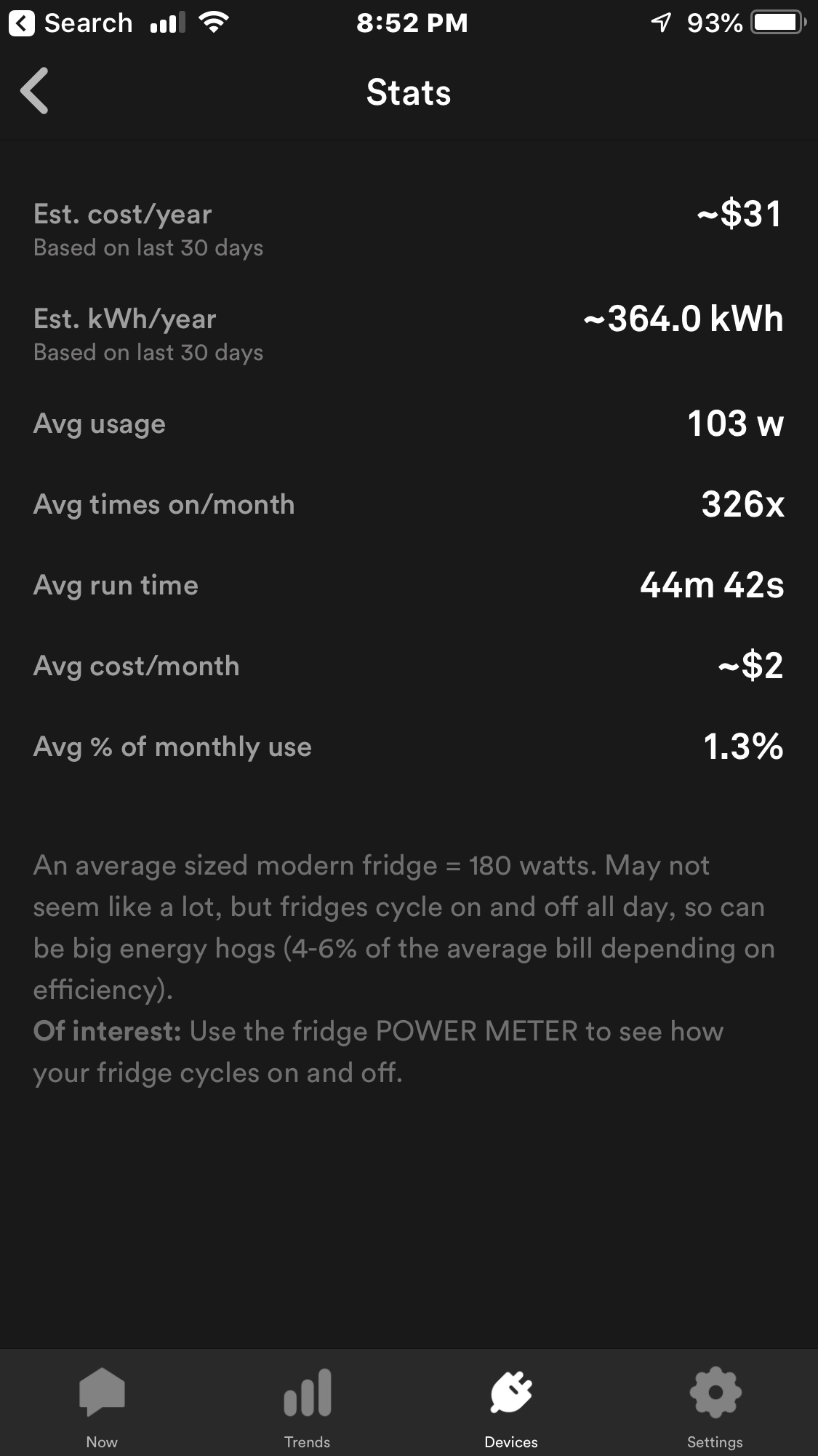

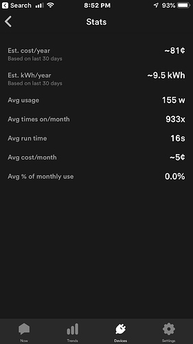

This is what you get if it’s on a smart plug and with each device this is what I am most concerned about. Oh and when it’s on a smart plug it learns when the device is idle or not so you can see how much power it’s using when at idle
top is fridge second is fridge light.
That’s what I’m talking about. See how many times it says it was on a month? It’s showing turning on and off when any amount of wattage above idle is used. I bet when someone opens the fridge door you get a notification for the fridge to turn on.
I would want to be able to know the difference between the fridge cycling or being opened as separate events. See how my fridge has separate devices? With a smart plug that’s out the window unless you first ha e the detections and then use the smart plug

I have not compared to a smart plug but have to a kill-a-watt. The compressor running is what I call “fridge” and that does show the same as th kill-a-watt meter. It’s what I’m interested in. Number of times cycling a day and fro how long the cycles run. When there gets to be more cycles, longer run times or both then I will know it’s time to service under and behind the fridge again with the vacuum and compressed air and the coils are dirty.
