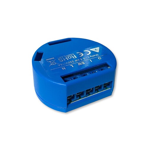

I feel your pain - been trying to work through the same issues as you. What I have done today for a workaround has been to make Home Assistant my top-level energy monitoring system. I still use some natural gas (furnaces and hot water), so I really need some place other than Sense to bring it all together. With Home Assistant, you could pull Sense data for aggregate usage and device usage, plus add something like Shelly energy monitors with MQTT for watching those nine 240V loads. And if you really wanted it all in Sense, you could send the data back to Sense via the interface. Right now, I don’t use Shellys, but do blend in data from my 2 240V EV chargers, and use the Ecobee integration to make sure Sense is detecting my AC compressors reliably.

Using a Shelly with Home Assistant
