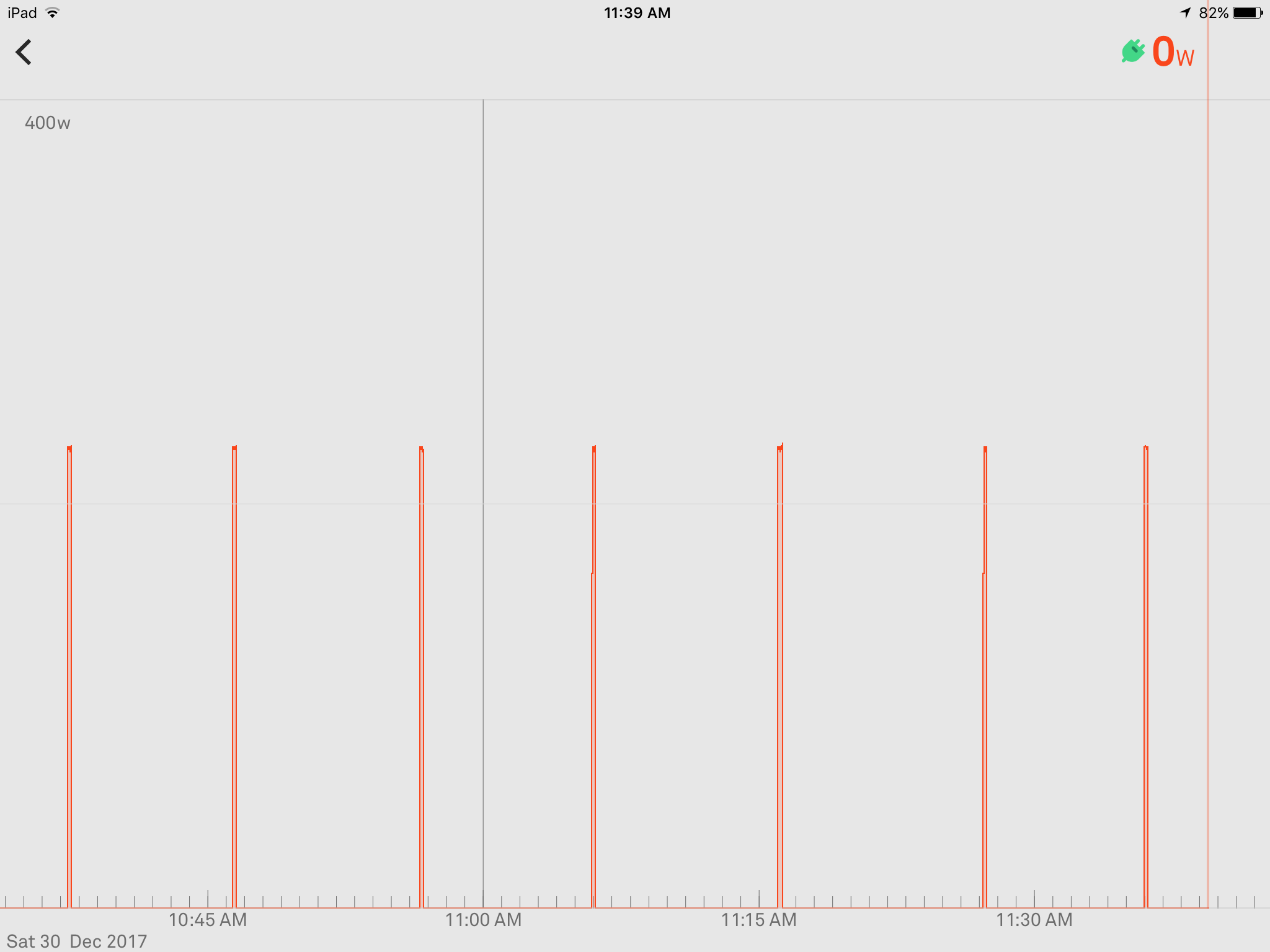

Hi, This is a strange one, and am hoping someone can assist. This device was detected almost immediately upon installation, but I have no idea what it could be. Doesn’t use much power, but runs a lot and for just about 20 seconds at a time. Any ideas what I should look for please?
https://screencast.com/t/1XUDW0yHMbVC
(I’m hoping you can read the screen capture above).
Would be helpful to see a Power Meter display from a mobile device, with enough resolution to see the switch-on transient.
Can you pull that event or similar from the power meter display just for that device? We’ll be able to see the transient better than in the Usage display
You could almost set your watch by it.
Worst comes to worst, you can shut off breakers individually to narrow it down.
Got it! I unplugged the Toto heated toilet seat, and it went away. Back on, and reappeared - same signature. It doesn’t use much power, but it does cycle on and off quite a lot. I see gaps when it goes into ‘power-saving mode’, but they are short and don’t seem to affect much. Thanks all.
