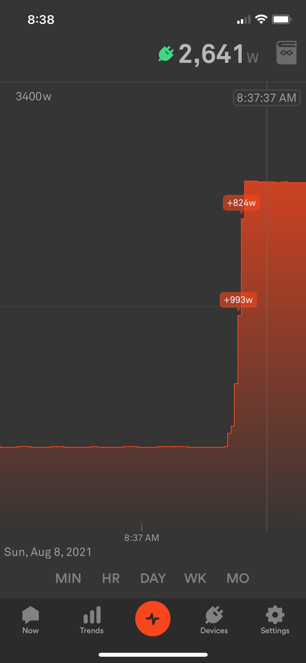

Here are some pictures of a one minute run on the default power level. It’s not identified by Sense yet but it’s very consistent and this is with my power lines very quiet.
entire minute
before
during
It seems to be using quite a bit more power than expected.

UPDATE
I was notified screenshots were posted. I just didn’t notice them. Sorry about that.
2641-634=2007 watts

Thanks for the screenshots - seems to clearly show 2000W consumption. Two thoughts:
  • How well has your Sense been correlating with your overall house usage and electric meter ? Just wondering if you might have a calibration issue on you mains.
  • The slow ramp of the microwave is identified as two transitions by Sense (the two tags). That slow ramp might impede detection.
