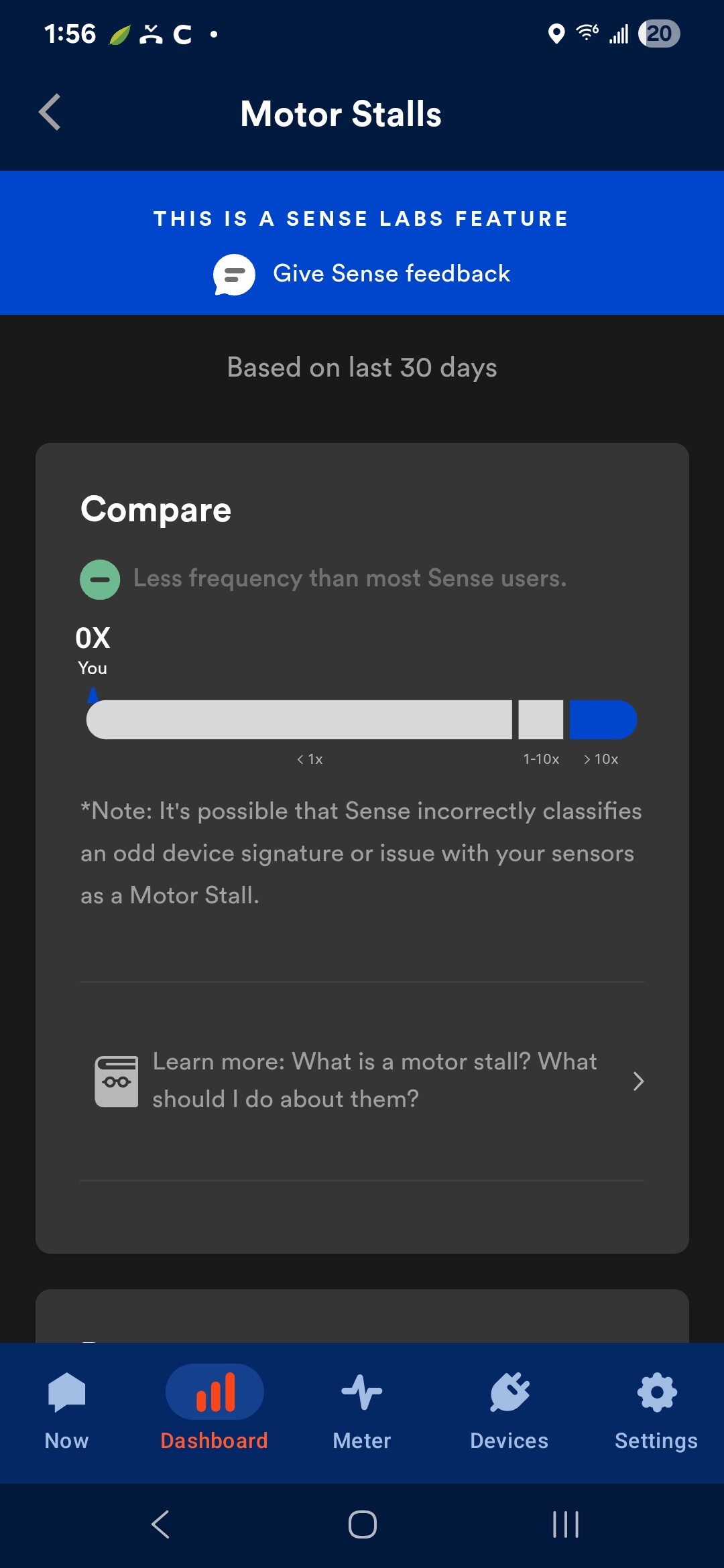

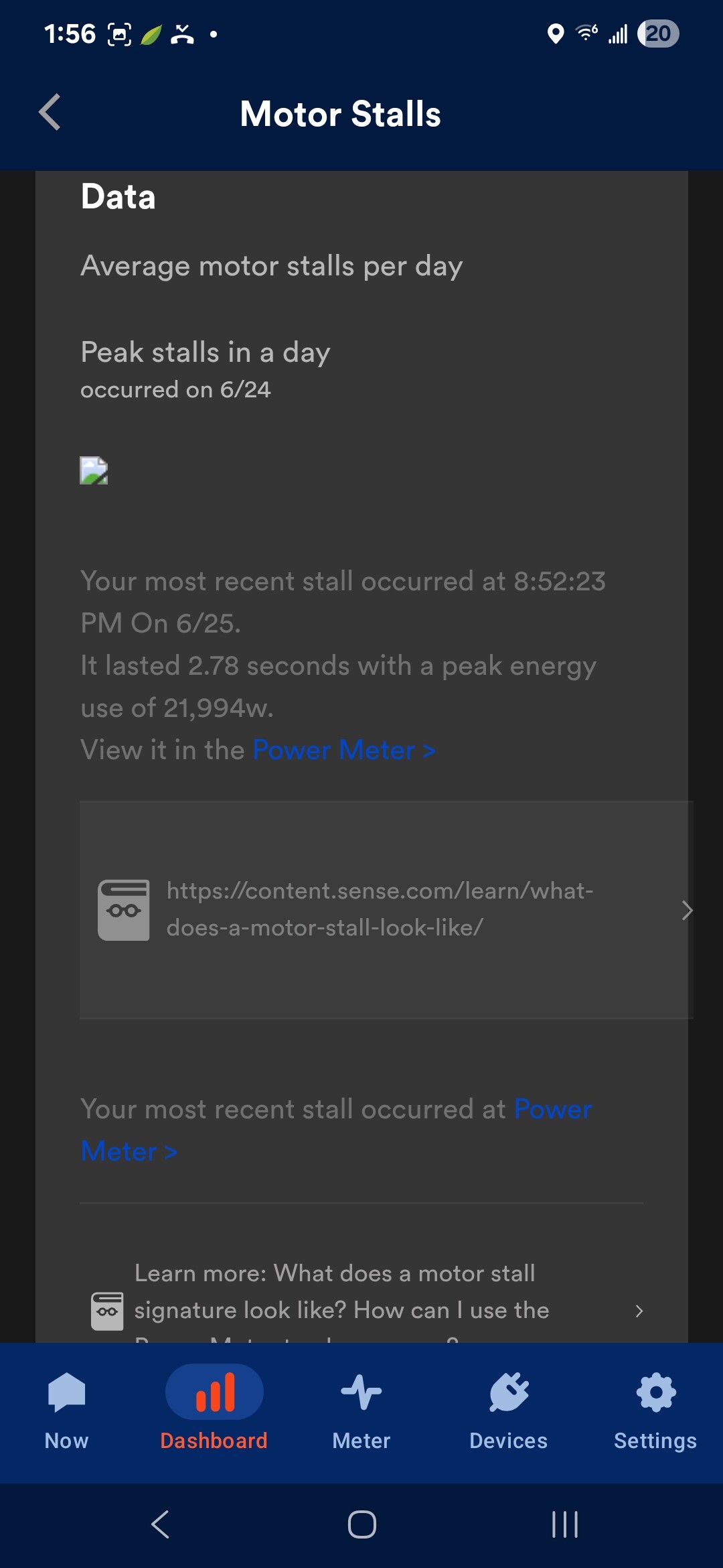

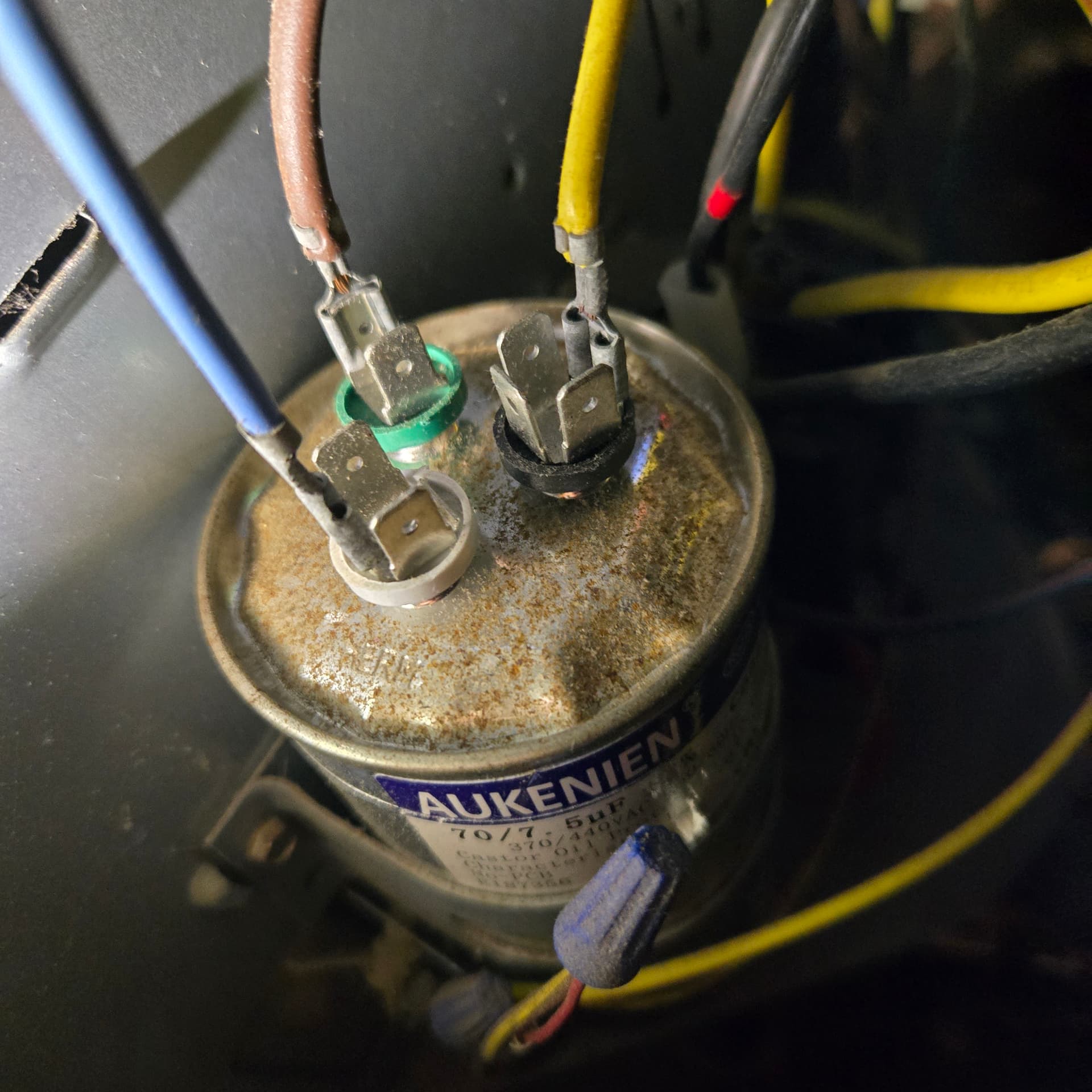

Today the capacitor on my central AC unit failed.
The sense labs says it did not see a motor stall but then provides info on the last motor stall which was today. Looking through the data, it looks like the capacitor started to fail a few days ago. I wish the app had alerted me as I would have purchased a capacitor at that time.
My central AC unit is a Carrier unit which I am including a photo of the specs.
The capacitor not only tests dead but it’s disformed with severe bulging at the top of it.
At the time of complete failure, my electricity use jumped from 4000w to 31000w.
Is there any way to have the app alert me to a motor stall. Even if it could display a message, I could use a 3rd party app to trigger an alert.
I believe there is a way to set an alert to high electricity use and will play around with that in 2 days when my new capacitor arrives.
