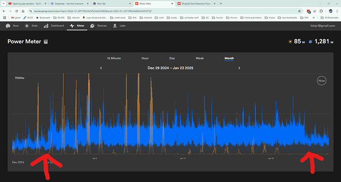

hello
i wanted to know if this might help the developers help the sense recognize issues
i have labs on and working but my sense didnt notice my sump pump failing.
apparently there had been an issue with it for a while you can see my normal usage over the end of dec and beginning of january

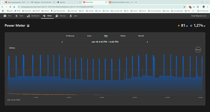

i did a few more scrre captures of the month prior to the issues and a close up of a couple hours on a dau during the issues and a day 2 months prior
one day i came home to find an issue with an electrical burning smell and found my sump pump had finally bit the dust luckily the water issues are not bad and it was not full enough to flood my basement
