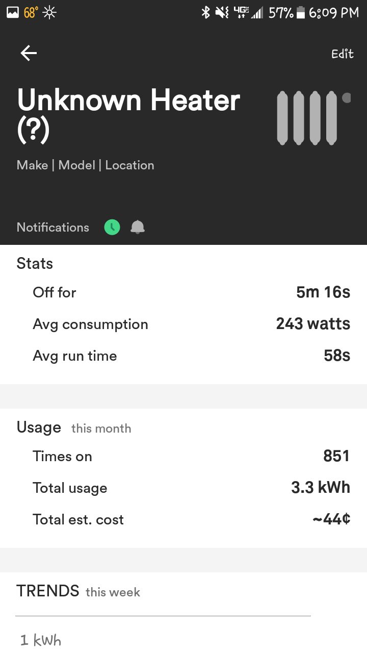

Unknown Heater, roughly 1 minute, roughly 3 times a hour

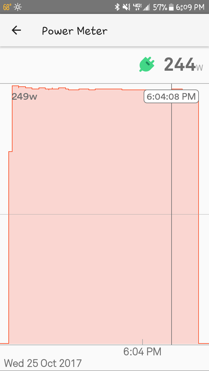

Runs 3 times a hour on average. Uses about 240 watts of power while running. Only runs for 1 minute each time. (55 seconds to just over a minute). Sense detected it as a Mystery Heater. Frequency of runtimes doesn’t seem to change throughout the day, but the gap between runs changes. Sometimes 10 minutes, sometimes as much as half an hour, but it maintains an average of 3 times an hour all day. All night.
If it is a motor, it has a very low startup current.
Some background:
Gas Water Heater, the rest of appliances are all electric. The AC has a blower that runs for 10 minutes an hour…so not that either.
Any ideas?

I agree that would help. What i do to determine 120 vs 240 is, if it a significant enough of a draw, is goto Settings\My Home\Sense Monitor\signals and watch the realtime wattage info for the mains. When it’s 110 you should see only one main increase proportionately, 220 would spike both. It helps to have two instances of the app running to correlate evidence of device turning on/off looking at mains to the timeline readout in the second app.
Thanks. I’ve tried that with mixed success. It would work better if I had two devices to run the app on. I don’t, at this time. The info shouldn’t be that hard to display in the app if they choose to add it.
