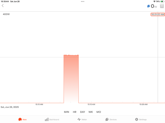

Here is a zoomed in look at the graph:
It turns on, runs for about 2 minutes, then shuts off. It has also “calmed down” a bit from a few weeks ago, when it basically was doing it non-stop all day long. Now, there are periods of no activity.
I have no other guesses of what it could be. We have a number of devices that are on smart plugs that we shut off at night so I have been able to eliminate a number of things that way.

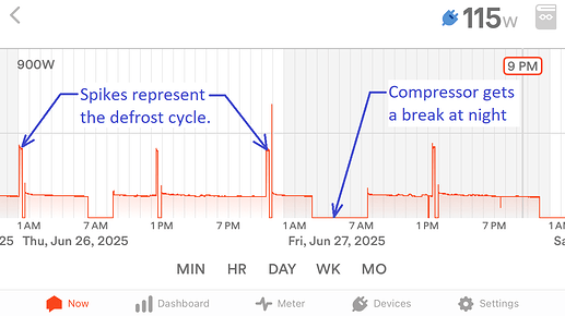

Do any of your smart plugs report energy usage to Sense? Putting your fridge on such a smart plug sounds easier than trying to turn it off within 2 minutes of the mystery device turning on. If the same pattern appears in the report of the integrated smart plug, then you would know it is a component of the fridge. I have my fridge on a smart plug, but its profile is very boring since it is the old-fashioned kind without an ice maker. Here is what I see:
My wife opens the fridge door frequently while she is awake, so the compressor runs all the time except immediately after a defrost cycle. The fridge only gets to relax when she is asleep. The point is, however, that if an ice maker were present and superimposed on this graph, it would be as obvious as my defrost cycle.
