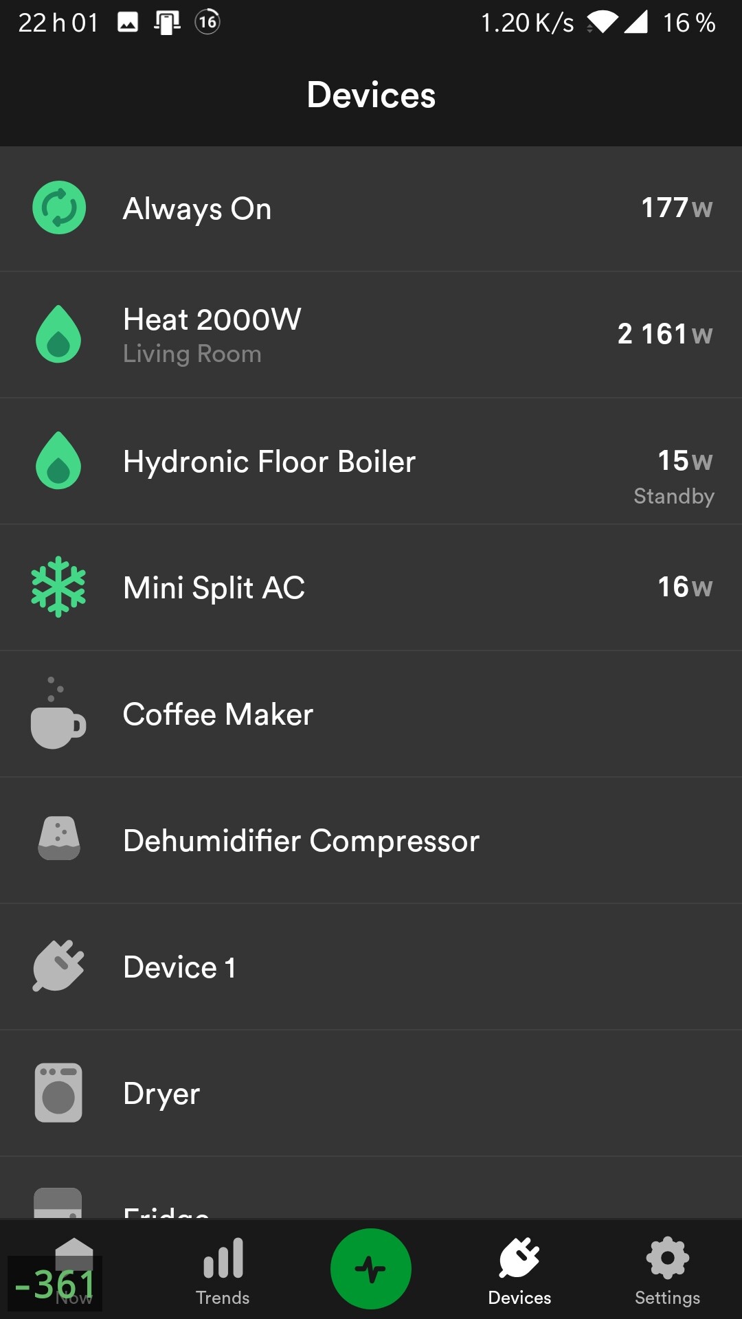

Strangely enough, Sense is measuring about 2 000 W for this same toaster-oven depending on the displayed tab?!
I turned on successively my baseboard following by my toaster-oven for few second each. Following picture shows Sense’s App Power Meter. We see that the height of the second device (toaster-oven) fits with 1 200 W if the first device (baseboard) is at 2 000 W.
“Devices” tab always shows my device labelled “Heat 2000W” at 2 161 W, no matter if the baseboard or the toaster-oven is on ! The same happens with Now tab.
The most strange behaviour of Sense’s App is that when my toaster-oven is on, not only Sense shows an impossible and wrong wattage, but it also removed the “Other” device.
