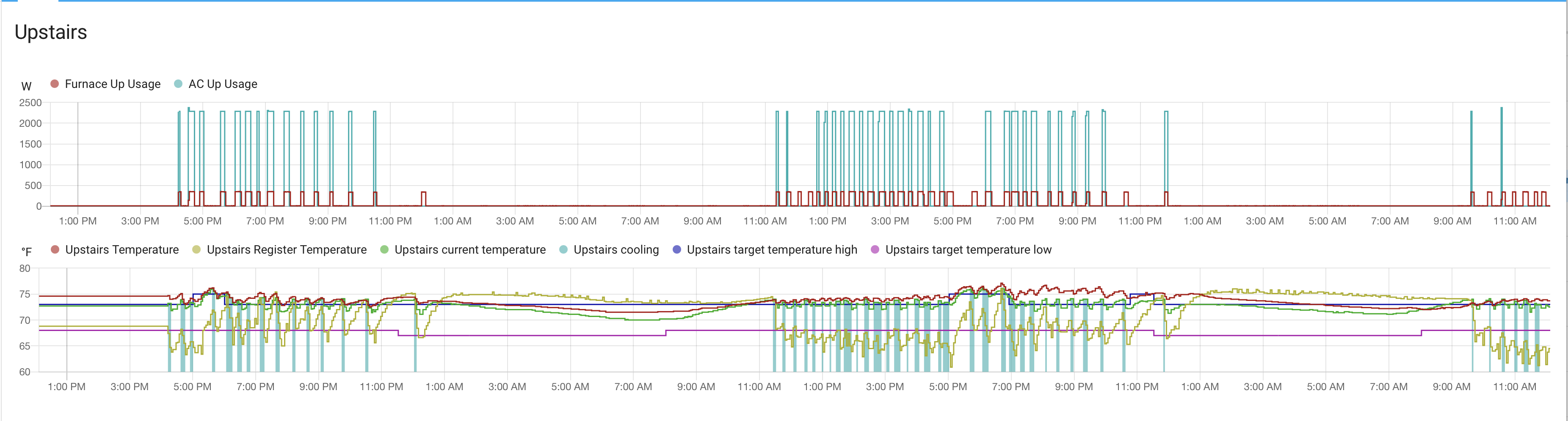

Sense has been doing a pretty good job of detecting my single stage AC compressors. The compressors are detected separately from my air handlers that are part of my furnaces, since compressors and furnaces are on separate circuits (furnace is 120V, compressors are 240V). Most of the summer Sense has been nailing every on/off, but I’m starting to see a few misses. In the Home Assistant graph below, you can see the power usage from my Sense (top) for both the air handler(red) and the compressor (blue), against the temperature and control information coming from my Ecobee (bottom). The misses are the red upticks on the top and the blue bands on the bottom that don’t have a matching on cycle in blue on the top graph.
Also very important for me to keep the air handler separate from AC compressor because they are orthogonal - the air handler also comes on during the winter with the furnace.
