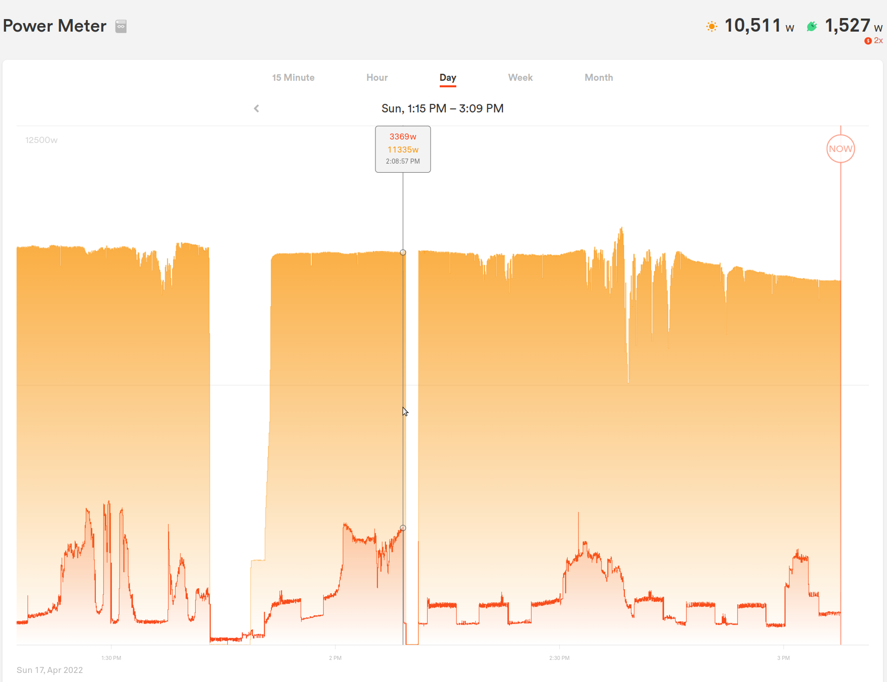

I came here precisely because I too had a very similar incident today - usage readings suddenly went negative while solar had a surprisingly low production day despite high sun and cool temperatures.
It’s almost as though the power calculations were off by 2 kW or so for much of the day.
Things appear to be back to normal basically as of the time I opened my mobile app.
And it is back!

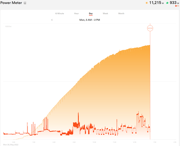

Graph from Sense:

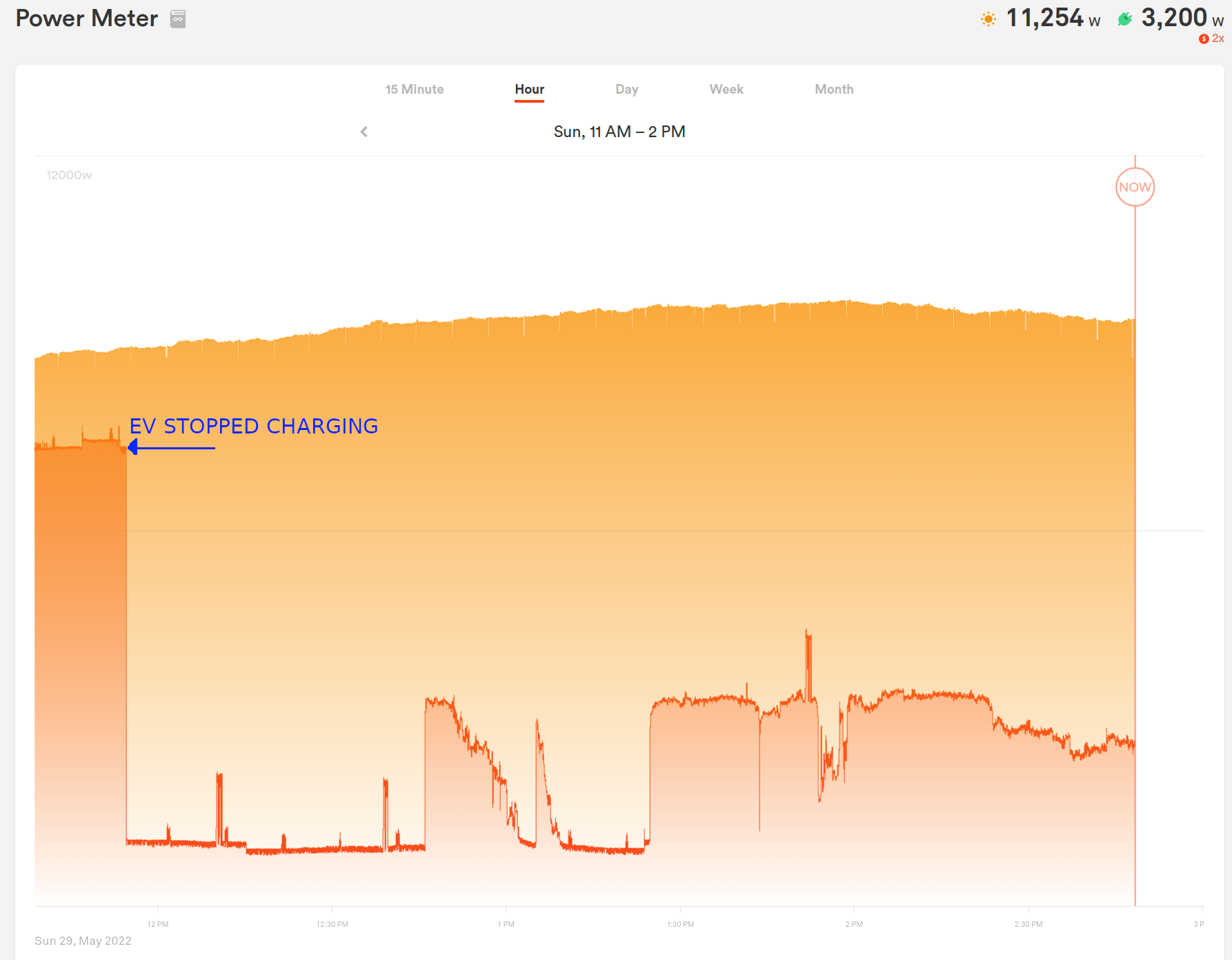

Yesterday it was clear to see that the (phantom) load was somehow connected to the solar production.
When the solar production got lower, the load also got lower.
When we had some (shadow?) event, you could see that in usage as well (blue circles)
Today however, everything is back to “normal”.
All usage accounted for, no weird stuff (yet)

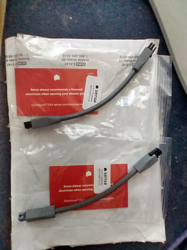

After reviewing your thread in the community and the data from your monitor, it appears that the issue you’re reporting may be stemming from micro-corrosion on the contacts of your main sensor cables. It looks like you caught this in an early stage.
To address this problem, we have created a short extension cable that includes slightly larger pins and a bit of protective grease. We’ve found that in most cases, simply inserting this cable between the monitor and sensor corrects the problem and prevents future connection issues.
Please Click Here and we will send you the fix kit ASAP.
Will install when it arrives and give an update.

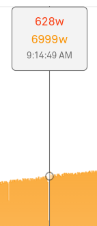

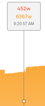

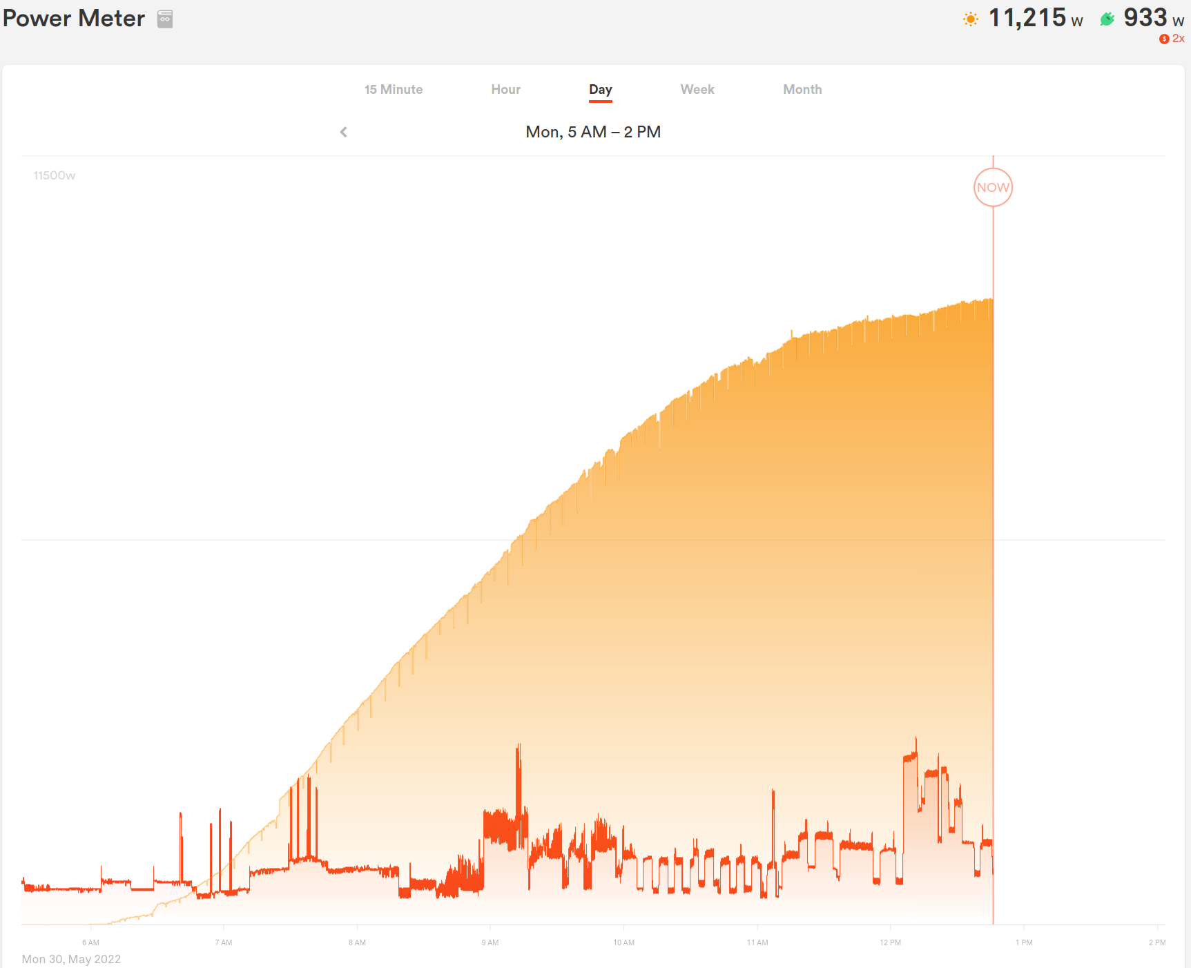

Out of curiosity, do you know why in the every few mins we have that line every few mins in the solar line… mostly noticeable in the initial climb in the mornings. On the meter it looks like its dropping 250w for a second every 3 mins .
Screenshot from 2022-06-01 09-39-50
Screenshot from 2022-06-01 09-40-05
579 watt difference
Screenshot from 2022-06-01 09-40-32
5 minutes apart
I have a real weird setup:
Enphase micro inverters (DL380,M190,M215,M250)
Sunnyboy 2500HF string inverter
Sunnyboy SB7700-21-US string inverter
Fronius 3800 string inverter.
I have monitoring on the fronius & enphase but not in the SB’s.
I have to assume one of them is re-calibrating the MPPT at that point.
But it is weird
I got a sunnyboy 5.0-1sp-us
Just 1 inverter. I recently added 10 modules / 2 strings.
Even when I was just running 1 string , I still got these marks.
Parts arrived
4" extension cables
