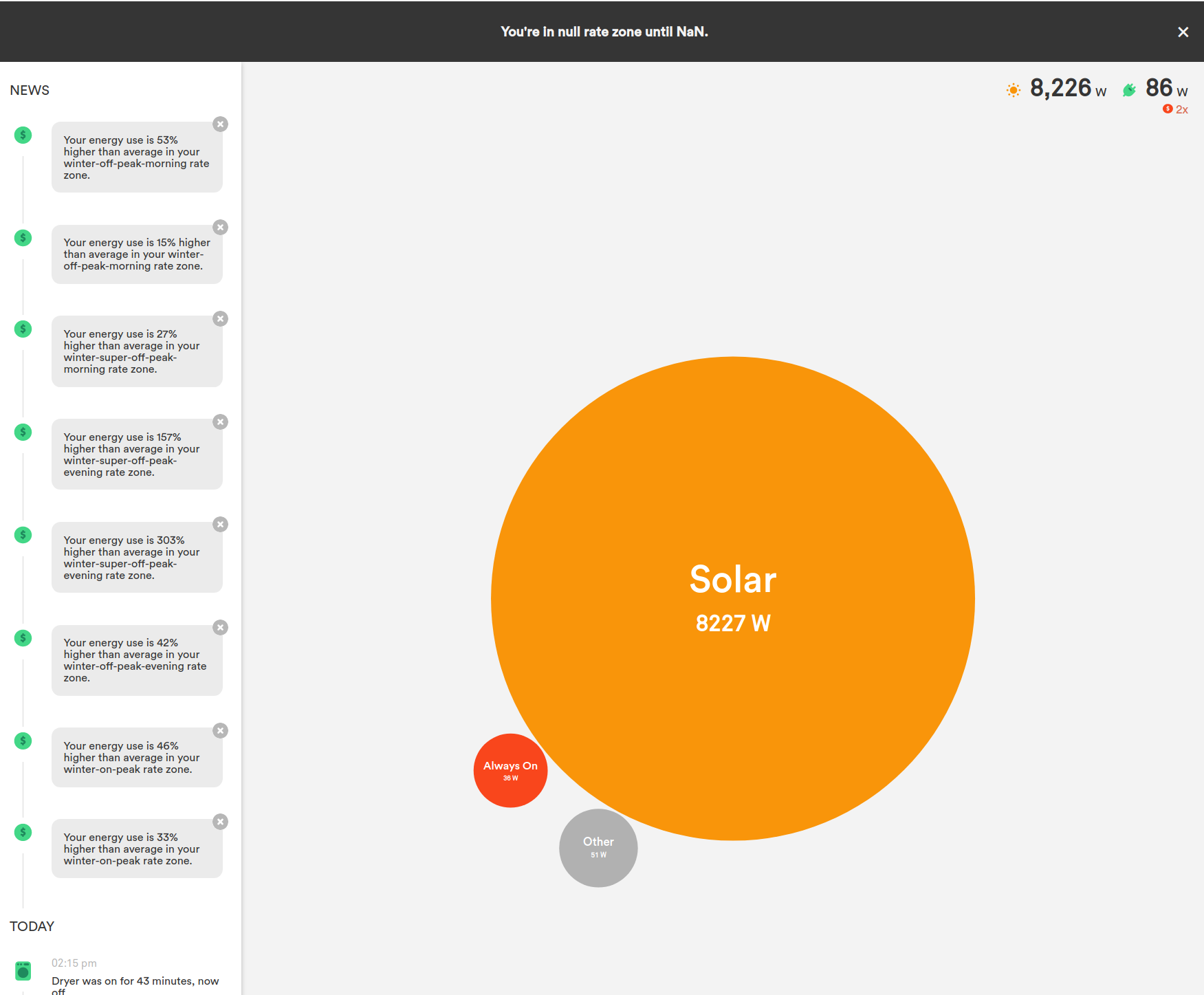

I found the settings → electricity info part and defined the 5 different zones between midnight & midnight.
When I now logon I see this at the top
And I am not able to “click it away” when clicking on the X
Not sure why you can’t click away. My guess based on the message is that you have defined TOU Rate Zones in the past, but don’t have any defined for the current time period, plus don’t have a "Default rate"specified. The error message means you are not in a rate zone. “NaN” means not a number so that indicates there are no TOU rate zones in the future.

And again: i can click all I want on the “X” , it won’t go away.
All looks good, though as you suggest, weekends aren’t entered yet, but you do have the default specified… It is a bit weird in that your winter-summer transitions appear to take place on different calendar dates (April 1, June 1, June 30, and July 30) but that shouldn’t be an issue. And all of the Rate Zones are current.

Hi @dannyterhaar. The Time of Use feature error you’re experiencing looks like a bug - Support will be able to look at this on our end. Thanks for reporting the issue and sending them an email.
Regarding timeline updates: you can click the “x” in the top right of the notification to remove it from the top of the timeline feed.
But they keep popping up (and taking over the time line) if I don’t click them away.
Is that intended behavior?
Each device you can select “do you want to see it on your time line?” but these useless messages are “always” on?
I thought you were referring to the top two regarding your rate zones, but it sounds like you’re referring to all timeline notifications (devices turning on AND rate zone updates).
There is not currently a way to remove the entire timeline from your ‘Now’ screen view. It looks like you’re on a Tablet (based on your screenshot), where I believe the timeline is a little bit more prominent than the Web app (home.sense.com) and mobile app views of the same screen. I included screenshots from my home of both the Web app and Mobile app for comparison, in case either of these options are more to your liking.

I only mentioned twice I am on the web app.
4K monitor on my desktop
Must have missed that, your timeline looks enlarged compared to my view in the Web app.
