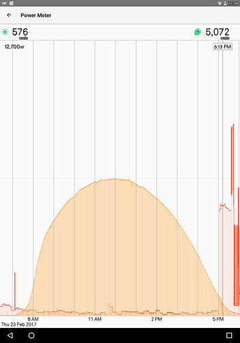

Post a pic of the panel and a couple 12hr screenshots (6am-6pm, 6pm-6am, etc) of your usage graph just to see if there’s anything funky. There may not be anything out of the ordinary, but maybe there will be
All the crunching is done in the cloud - the device is just sending electrical data and the analysis and model fitting happens above our pay grade. If your data is clean, I don’t think you should be having so much trouble. If you’ve got a wonky ct or a hitch in your install, then the data being fed to the model could be bad making appliance fitting difficult.
Also, it looks like you have solar leads (at least I can see there are a pair of leads plugged into your device), but I don’t see solar on your graph?
And there’s some other panel somewhere? I can’t tell where your Sense is getting power - I don’t see the power wires running up into that panel box with the main CTs. (never mind, I think I see the power leads coming up to that 20a breaker, neutral going to the neutral bus).
I have Sense solar, but by coincidence my inverter went belly up just after I got by Sense, and I have not got around to dealing with it, partly because it’s been so rainy and not seemed urgent. The Sense Solar CTs are in the Solar disconnect, which is just out of view of the photo.
The power to the Sense is the uppermost breaker (unlabeled) in the picture.
Yes, I have two electric cars, however the load from 6-9pm is mostly household I think (alas, Sense can’t enlighten me) The EV chargers are normally on timers 11pm-6am, which is the cheap power window. But sometimes we override the charge schedule and start earlier. We only have 120v (~1500watt) chargers, and 7 hrs is only ~1/3 charge on the car, which is fine most of the time because we don’t use more than that on an average day, but sometimes not and I start charging when I get home ~6ish. I don’t recall what was happening that day (even though just yesterday!)
