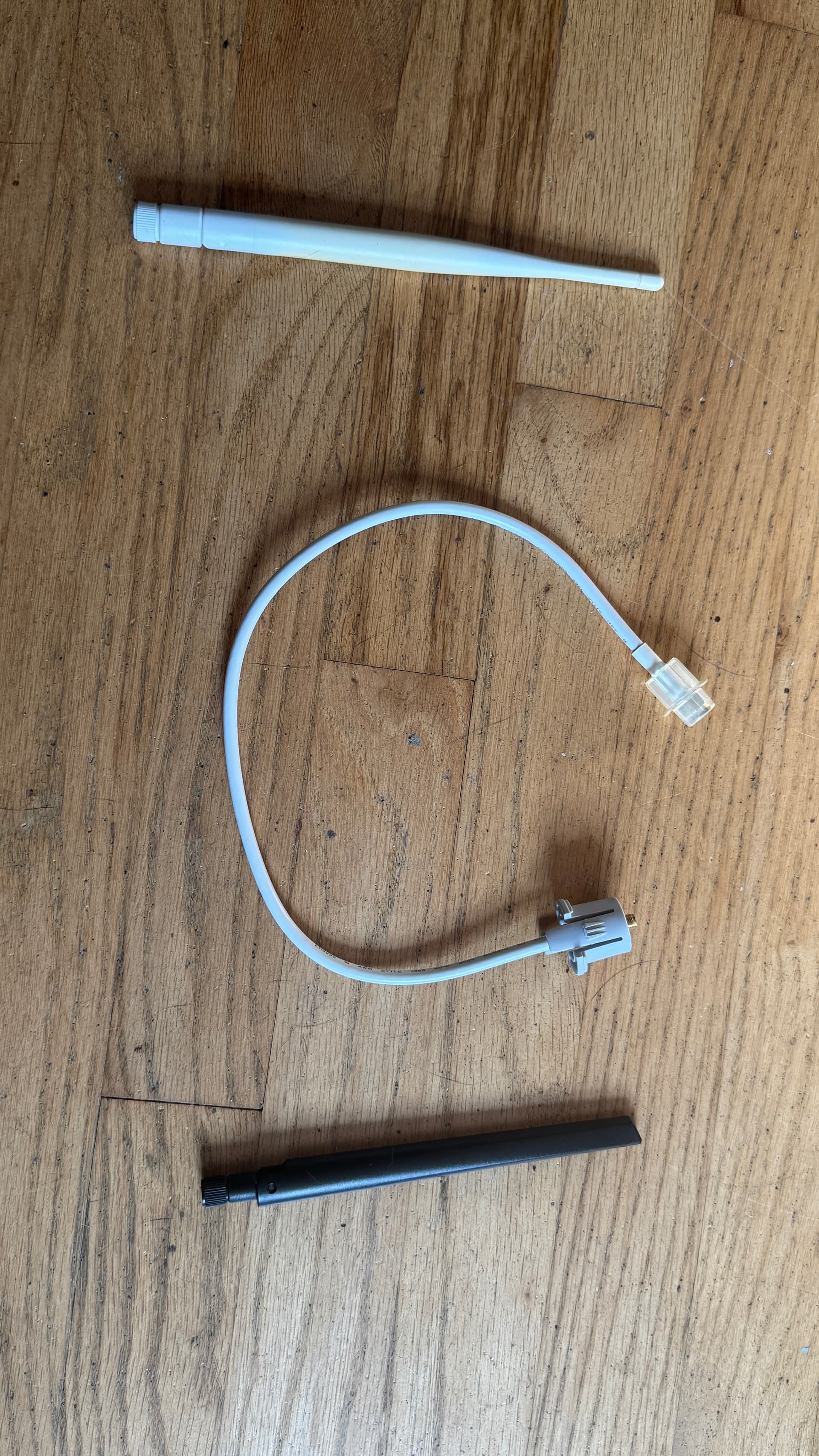

I have several antennas from old routers and the sense connector that you can have, if you are interested. My monitor is connected outside the panel.

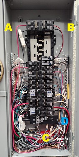

Thanks for the offer and thanks for pointing out that the antenna side is also just an SMA connector (I thought that side was molded, but never looked!), so I will take the opportunity to get something with a longer cable so I can move the Sense unit in a more serviceable place (A or B, using the Sense holder). The electrician wedged the sense in the most crowded place behind all the wires at (D) with the antenna cable forced into a 90 degree bend touching the main shutoff. I now relocated it to (C).
As you can see, the punchout for the antenna is in the lower right and the existing short antenna cable limits the placement to the lower 1/3 of the panel, which is not ideal.
