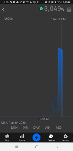

Interesting - like you are seeing real 3800W spikes for very short periods of time (10 sec ?). Since Sense thinks it is AC, it’s likely a motor of some kind. One question - have you enabled Sense Labs ? That might also give a clue.
As @kevin1 mentioned, those 3800W spikes are probably your biggest clue. Since Sense suggested an A/C, I agree with the thought of a motor here. Probably something on the bigger side. I usually start with a review of my labeled panel documentation to see if there’s anything i’m forgetting about (pumps, water heaters, etc.) that hasn’t been fully detected yet.
Waveform does look like a heater, but the amount of power is quite a bit less than most domestic water heaters draw (around 4kw). Possibly a smaller/local (like under the sink) unit? My prior house had one in the kitchen to provide instant hot water, but I have no idea what it drew or how often it ran.

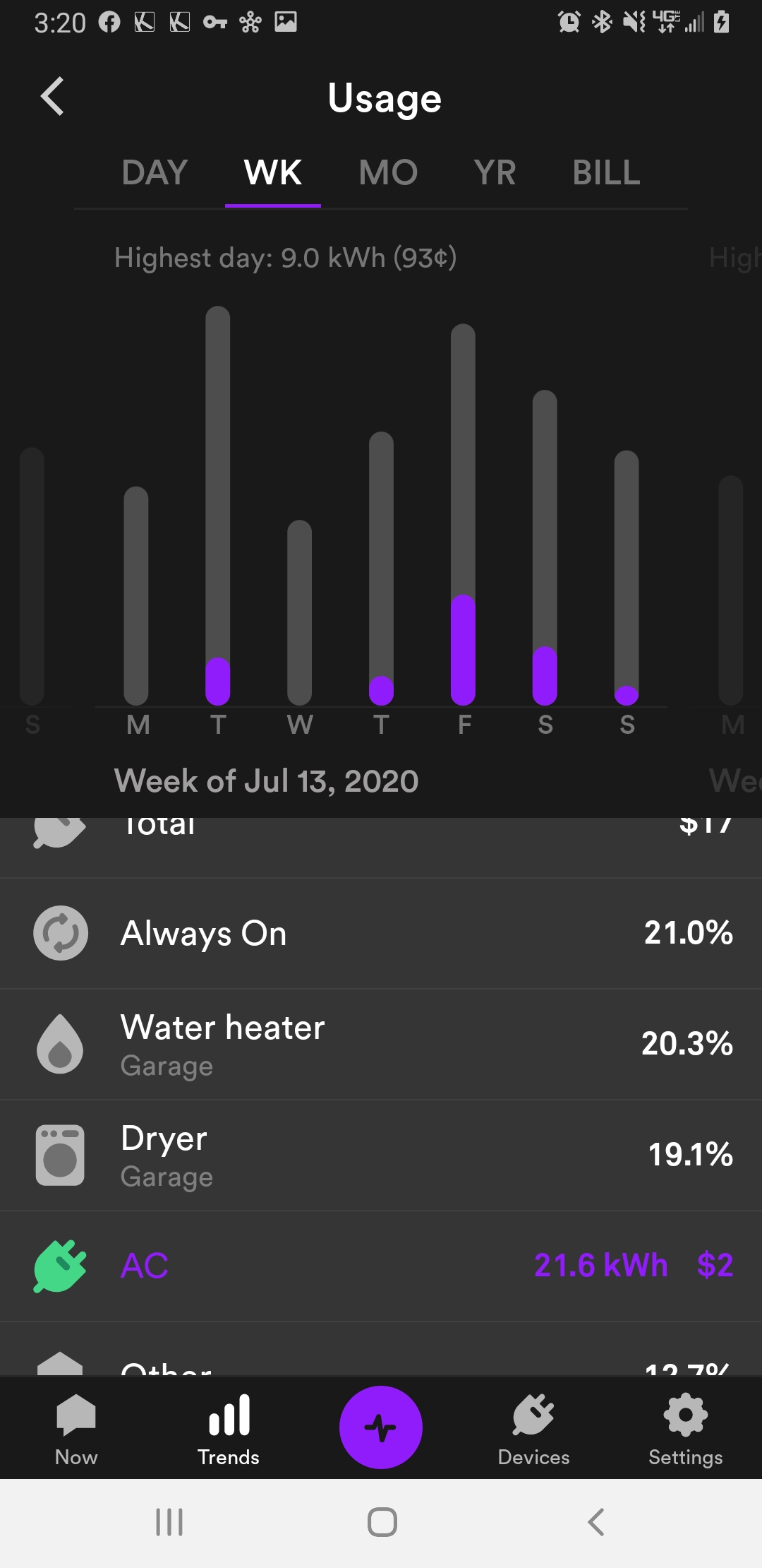

There is definitely overlap with the dryer.
If the dryer is 5k watts and ‘AC’ 2k watts my total should be 7k used. However this is not the case. My total current burn (pun intended) is under 6k.
I could speculate it’s a motor in the dryer. However, t that won’t explain the times “AC” comes in when the dryer isn’t in use. The previous examples of 10 second spikes.

I only have the wall heaters, oven/stove, the dryer, and a water heater on 220.
I’m inclined to think dryer drum motor, if it must be on a 220.
However The ‘AC’ spikes have occured all hours of the day. Even when I’m not using the dryer. It’s perplexing.
If I could better look at the timeline and see what’s on at the same time for the last week. it would be easier to figure out.
I think some 240v device is on, unless you have some sort of awfully coincidental combination of 120v devices turning on at the same time. A standard 15A 120v circuit can supply 1800W maximum, even a 30A 120v circuit (uncommon in US residential settings) would be hard pressed to deliver the amount of power shown in your realtime usage chart there.
Definitely a head scratcher, but given the signature and amount of power this pretty much has to be a 220v circuit. Do you perhaps have an auxiliary breaker panel…many homes do? Typically places like a garage, a workshop, etc.
