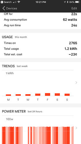

This is one of the first devices sense detected and I’m at a loss.

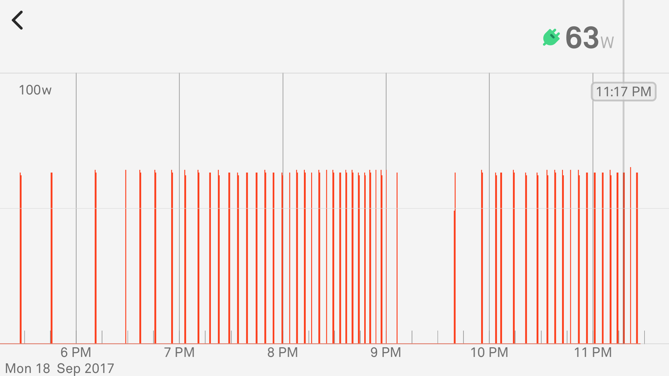

Can you post a close up of the power profile? It’ll probably help to ID it.
2765 times on in September.
2765/18days = 153 times on a day
153/24hrs = ~6 times on each hour.
I have a motion detector but all lights in and out of house are leds
Ups bumping the battery, Or something charging. That is an odd one.
Some newer devices will bump the battery up to full charge and then discharge to 95% or so and then bumped them back up. Could be a laptop tablet something of the sort.
Thank you. I unplugged both laptops and most of it disappeared. I’m guessing the rest is my wife’s camera battery charger.
