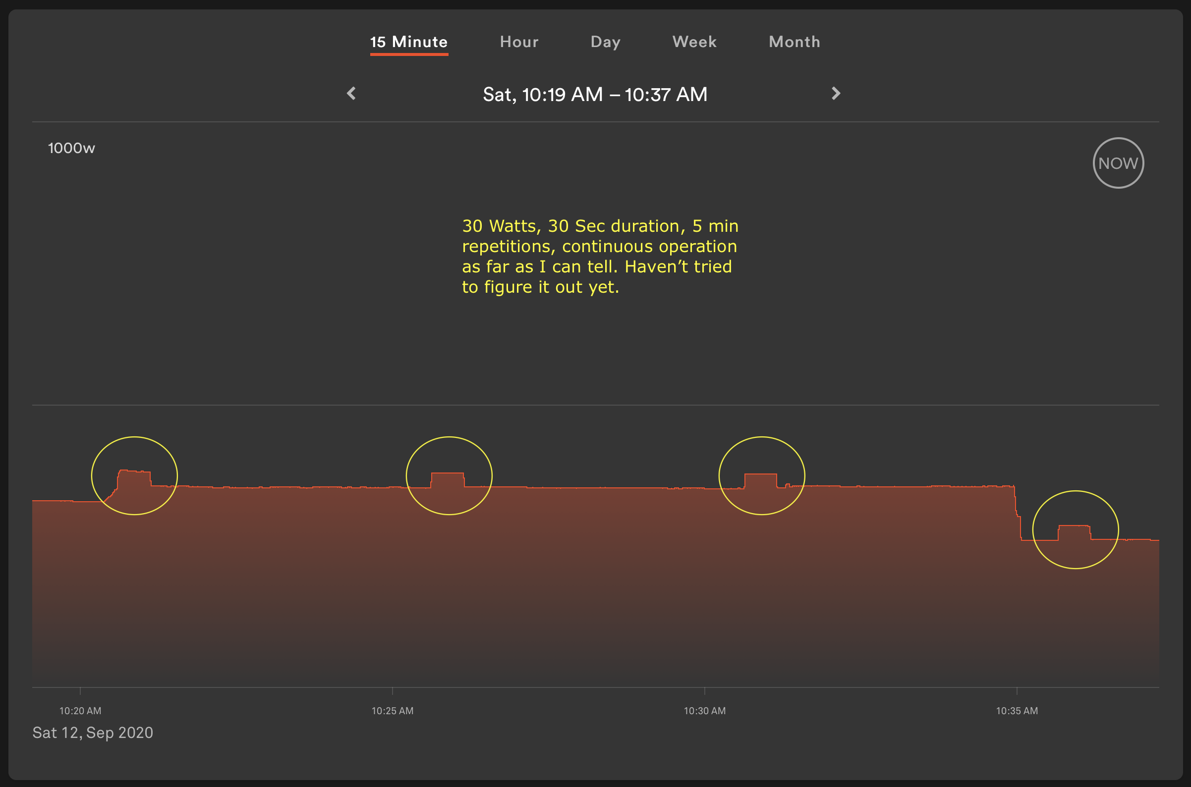

A picture may help. I’m rooting for refrigerator defrost cycle, but most of my guesses have been wrong so far. That’s one of the proofs of the education I’m getting from Sense. :))
I dont think it’s a defroster because those have a curve in the amperage vs time aspect. Those use a couple hundred watts but this uses 58 watts from on to off everytime
It’s on every four minutes and on for how long? 60w is not that much but on a lot. What kind of device was sense think it is or suggest from the community?

so im 90 % convinced that its a battery charger i swapped batteries on the charger yesterday night and got a notification “device 1” was on 9 times again the same 58 watt perfectly flat power meter reading
one time it was on for 11 min though i want to try to replicate it to make sure but all of my batteries are charged now…
guess ill have to do more projects so i can charge the batteries again
oh and btw its a makita charger and i am charging 18 v batteries.
