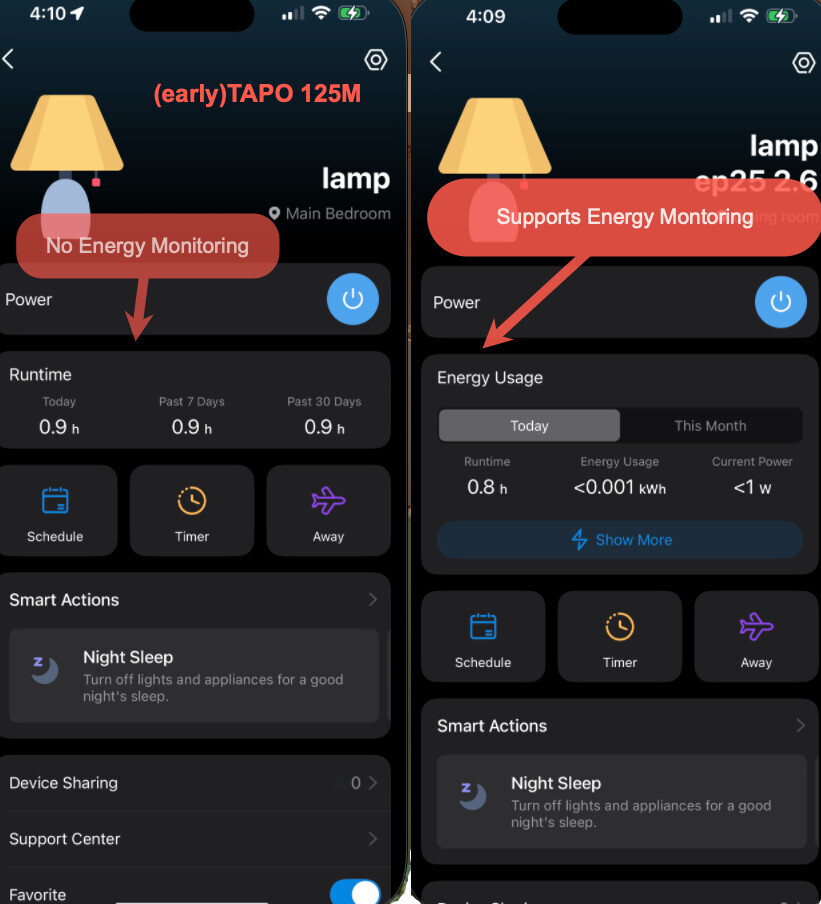

  • Not all smart plugs listed here may support energy monitoring—they may only work as switches, if at all.
  • All supported plugs are required to monitor energy; however, there may be some confusion around this.
    • For example, some early Tapo 125M devices do not support energy monitoring but will still show up in the Devices list in the Sense app. The switch function in Sense may appear responsive but does not actually trigger the switch or reflect changes in the Tapo app.
      • Although quickly identified in initial testing, similar issues may arise with other plugs if they lack energy monitoring capabilities.
    • The best way to check if your device monitors energy is to open the Tapo app > Home > Click on a device > Look for a category > Energy Usage.
      image821×904 109 KB

Also, I would make sure your 125M actually is an energy monitoring plug. I bought an early Tapo 125M plug and it does not monitor energy. This can be found by opening the Tapo app, going to the plug, clicking on it, and seeing if there is a banner that says “Runtime” versus “Energy Usage.” If you see “Runtime,” then it will not work with Sense. I’m just trying to make sure because I specifically ran into this issue with the KP125M (though it was Tapo KP125M, so if it’s Kasa or monitors energy, it may be a different story).
