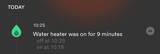

I’ve been get tons of these lately. I’ll have an alert created to let me know if a device has been on for a certain amount of time. Take my water heater, if it’s been on for more than 20 minutes, then I get an alert.
So I get these alerts for the water heater and other devices with similar alerts set and they are wrong. They have not been on for the specified time.
Anyone experiencing this?
I’ve contacted support and was given the answer that it’s working properly. How is is that?
Here is my water heater alert screenshot and one for the power meter taken right after the alert popped up.
Notice how the water heater wasn’t even on at the time of the alert.
And another. These are becoming much more frequent.
Not sure, could be user error?
Sure, maybe.
Please explain. I’m not able to see where I have caused this but am fully open to that possibility.
Under the Water Heater device management do you have “Show on Timeline” ON?
If so, you can compare the timeline (in Now) with the alerts and narrow down whether you’re experiencing a bug.
I do have it set that way. But you can only see the tags on the now timeline when the Sense app is open. I can clearly see the 4500 watts from the water heater on timeline and power meters.
It’s definitely a bug
Seems so in your case.
Verification through the Now listing also mismatches from the “20 min”?
