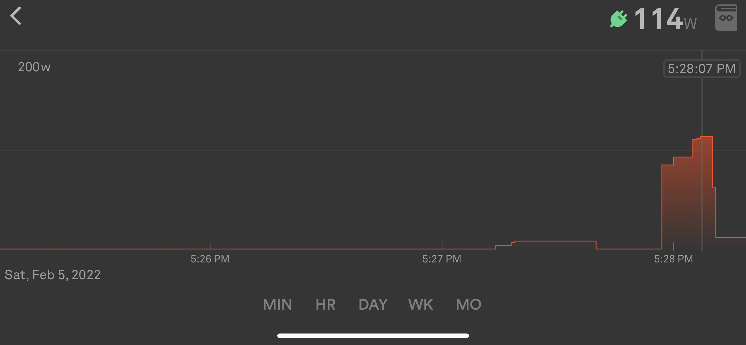

I’ve had this device for well over a year, he shows up as a light, seems to kick on randomly. Doesn’t seem to matter if I’m away, sleeping or home. Seems to bounce 114w, 90w, 81w and 1w. Sometimes it will stay on for 10 mins, sometime over an hour.
1504 times on over a year ~= 4 times a day.

The chamberlain B980 has WiFi/ MyQ and a battery backup build in. It looks like it peaks at 114w when I open the door but followed by 14w for 8 mins (lights). Standby is 2w but the plug shows 10w every 10 mins or so that last 15 seconds. I will let you all know when “light” clicks on.
The device showed up as “Light”… is Not the chamberlain B980 garage door opener that I have my Kasa plug on. Light kicked on today and it doesn’t show the wattage
