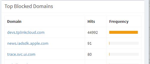

I have around 10 HS110s installed. Recently I installed a pihole ad blocker on my network. This is a screen snap of its most blocked addresses. Its a 24 hour moving average.
Does anyone know what its doing? Pihole blocks DNS queries so its saying that 44992 times a day the HS110s try to resolve devs.tplinkcloud.com. Thats about once every 10 seconds. I thought that was rather excessive so I blocked it. It hasnt seemed to impair its operation as far as I can tell.
From the screen snap you can see the next most active device is only 91 queries a day. Roughly 95% of my daily DNS queries originate in HS110s.
Should I unblock it? Is it hurting interoperation with Sense in any way that I havent yet detected?
