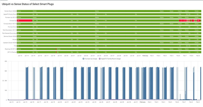

Here’s the other thing that’s so befuddling… I have created a HA dashboard that now matches up the Ubiquiti presence monitor for select smartplugs (Home/Away) with their Sense binary_sensor companions and have caught my Furnace Up HS110 going rogue, but Ubiquiti shows it as connected (Home). You can also see the dropouts in the Furnace Up waveform below.
When I try to ping that HS110 I get mixed results. A ping from my router (UDM) or from my video server (Mac Mini-left), both wired, are successful. The same ping from my MacBook Pro (right), is unsuccessful.
I’m fairly certain something that HS110 is doing is screwing up it’s accessibility on my network (simple - no VLANs, but multiple SSIDs right now). Not surprisingly, the ARP table for the MacBook Pro does not show an entry for the IP address of that HS110.
And just to make it more interesting, the offending HS110 is visible in the Kasa app and does produce power info.
ps: This is a different problem than I initially posted but continues the endless story of data dropouts. Time to reboot this bugger in the attic.
UPDATE: And of course, a power cycle of the HS110, cleans up the ping problems. And I’m betting that the data dropout will disappear, at least for a bit.

One more datapoint - here’s a view of an entire month for the Furnace Up HS110 that seems most prone to going full on “zombie mode” and dropping data to the Sense monitor. The problem is that it works reliably for a long period (in this case 22 days), then goes rogue again.
