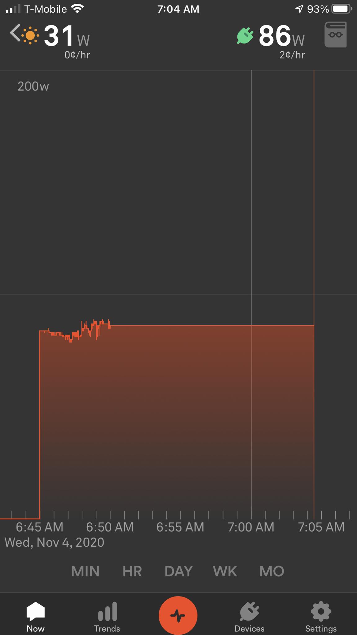

It doesn’t come on often, but when it does, it burns about 90W for a significant amount of time (not hours…but not a few seconds either). Also, it often doesn’t come on for days at a time…

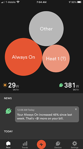

This morning it came on (I took some screenshots below). There is very little going on in my house at 7am in the morning, so I “sniffed” around the house to see what was on, and it appears that my refrigerator is humming along, even though my refrigerator compressor (which is one of the few things that has been identified by my Sense) does NOT show as being on. And when the compressor is on, it is usually burning around 150@, not 90W…
Is it possible that this 90W device that rarely comes on, and sometimes does not come on for days at a time, is a component of my refrigerator? It’s not the freezer light… It’s not the refrigeration light… It’s not the compressor that runs regularly every hour or so… But yet my refrigerator is making some humming noises right now and I have this 90W device that Sense has labeled as default as “Heat 1”. I am baffled… But the refrigerator is the only thing buzzing at this hour… Any thoughts?
Bubble Screen
Device Screen
Power Meter from “Heat 1” Device Screen

Ha, I just posted a topic about this. If you have a smaller refrigerator with auto defrost you are probably seeing the defrost heaters activating.
Thanks @Rjenk0s - So a device that burns ~90W about once a week sounds like an auto defrost?
It could possibly be that. If you can catch it on unplug it and see if it goes away. Depending on what the refrigerator is you can usually trigger a defrost manually.
Note that unplugging a device won’t necessarily make the bubble go away (because unplugging may look different than a normal shutoff). The “unplug check” would have to be by looking at the power meter screen (where you see real-time consumption) to see if there’s a drop in consumption matching the usage of this device.
