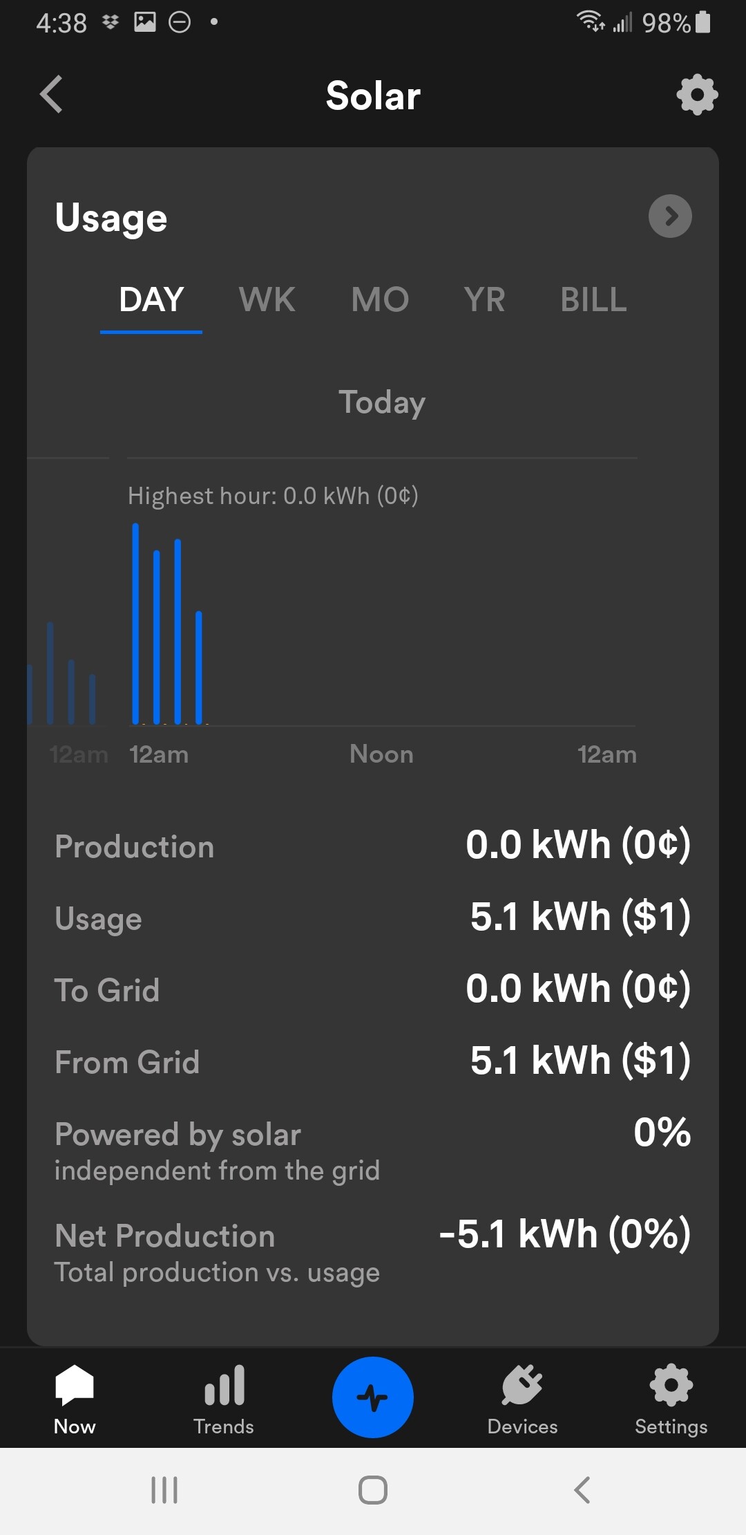

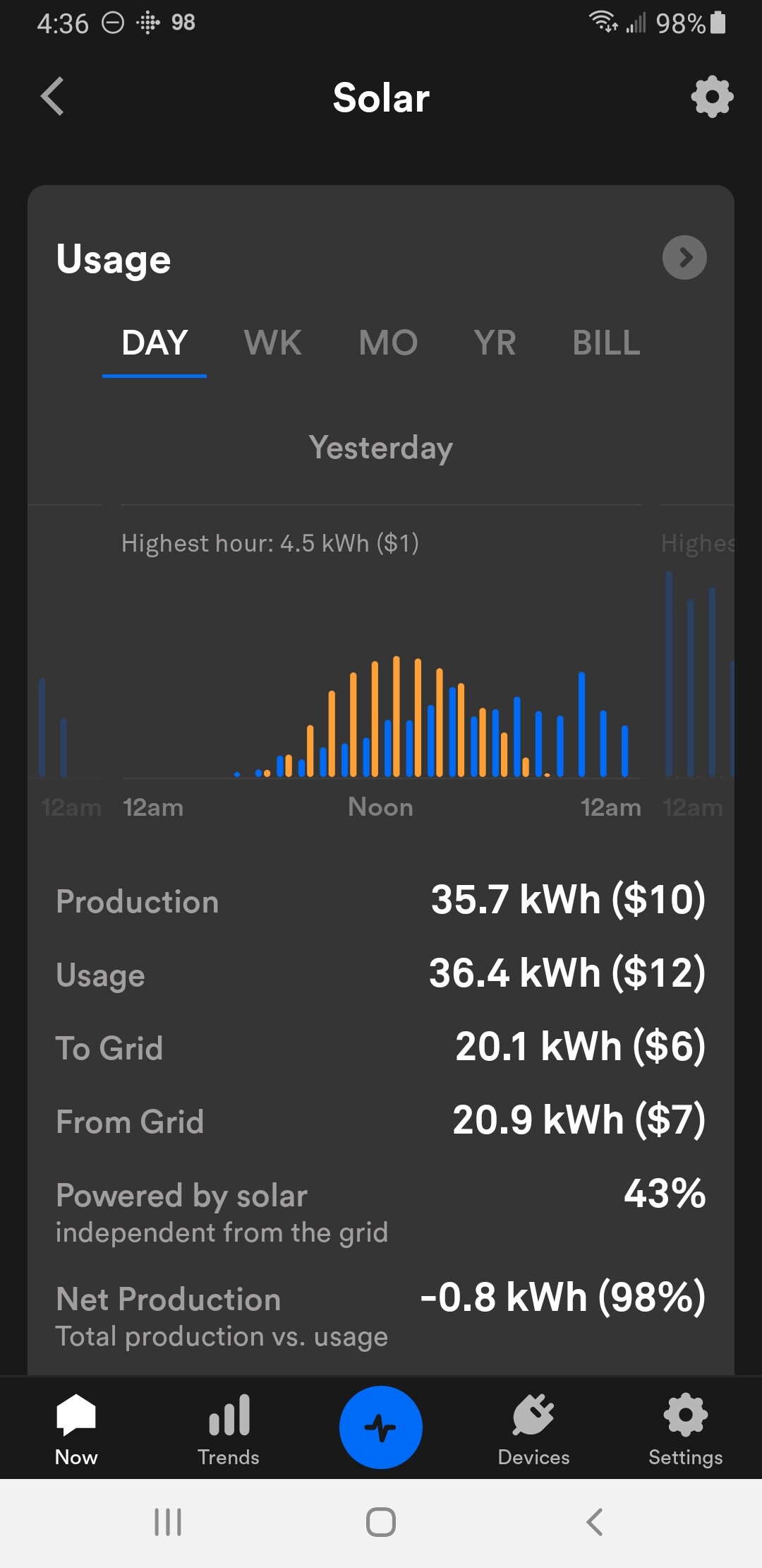

I just noticed that my “From Grid” numbers on my Solar daily screen don’t match the numbers from the Rainforest. They used to be within 0.1 kWh of one another. Any ideas why this might be happening? You can see yesterday’s and today’s data in the pics.
There was a known Sense service outage yesterday. I’m missing data from about midnight to 5:30AM Pacific though it might get back filled. It looks like you are missing usage from your Sense in the 6/14 early morning hours as well. A partial cause ?
@kevin1 Thanks, Kevin. Yes, that would explain the 6/14 discrepancy. Now I need to figure out what happened early this morning with the 5.9 kWh from Rainforest vs the 5.1 kWh from Sense. Hopefully, it’s just a hiccup.
