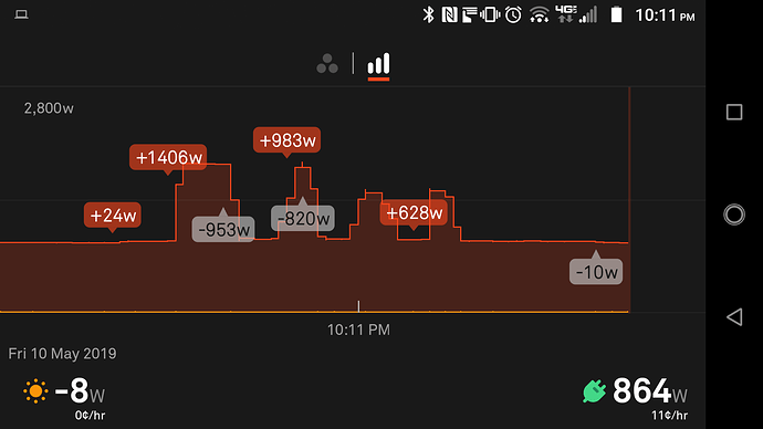

A couple days ago, something in the house started cycling. It has been consistently using 500-700 watts for 2-3 seconds about every 30 seconds since then. All the kids were in bed and my wife and I were watching TV. 700 watts is an awful lot for something I can’t find. I’ve been in all the kids rooms and unplugged everything more than a nightlight. I jiggled all the knobs on the oven and made sure all the burners were cold. There’s nothing like a hair dryer or curling iron plugged in (or any other normal plug-in heating element).

This is a closer look:
There was a user that heat tape to prevent ice dams that resembled this
Thanks for replying. I don’t have anything like that. Am I right in thinking I looks like a motor with generally a short spike as part of the waveform? 700W seems more like a heating element, though.
Those spikes usually indicate a motor, especially at the beginning of the waveform. I do have a heating element that also has spikes so it can be confusing.
What you have appears that it could be a motor or heating element to me. That’s a lot of electricity at 700 watts.
The only device I have that comes on every minute for a few seconds is a Keurig, I wonder if you have something malfunctioning?

If you fridge is detected you can look to see the compressor consumption. If it’s running more than it should then the defrost could be stuck or malfunctioning. Those defrosters are usually around 500 watts or more

This is what is normally looks like:
It hasn’t been recognized yet, but you gave me a thought. Maybe it’s the defrost cycle. I don’t know how long that should last…

It was the laser printer! Seems like my wife printed some things, but it ran out of paper. I guess it was just keeping warm until someone added paper.

Screenshot of my printers fuser (Sense Detected) below. If memory serves, I sent two jobs about a minute apart in the first chunk, and then a third page around 3:22. Not detected area all the other parts of the printer (rollers, paper feed, fans etc…)
