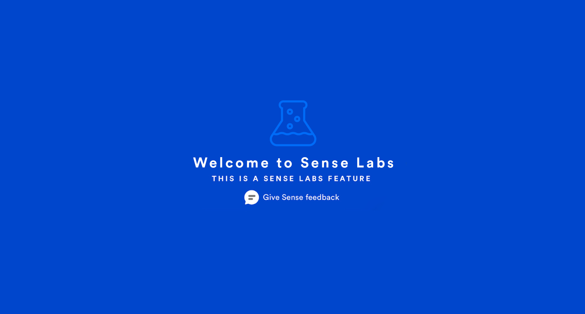

Nowhere on the on the sales page link does it mention it is a preview or an incomplete experiment. Sense Labs - Sense.com
Just a suggestion to pass along, if a feature (as desired and useful as this) is used as a marketing point it should be an actual feature, not a many year old ‘new’ preview that is “experimental and can be unreliable or break from time to time”. This appears to be intentionally deceptive.
