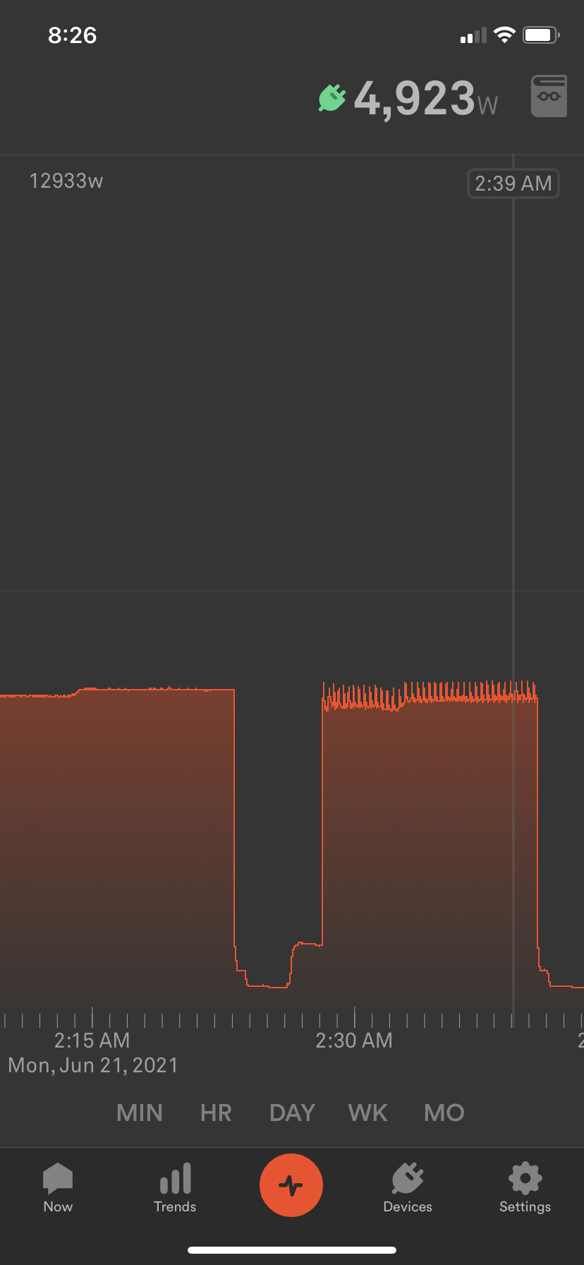

Any idea what could be going on here? This repeat 200w signal occurs every 18 seconds (start to start) when my a/c is running. The spike last for approx 7 seconds. Seems to go away when a/c isn’t running.
I have a 3 zone system with a 2 stage compressor and I’m trying to figure out if the spike only happens when aligned in one particular configuration.
Trying to determine if this is an equipment issue/ failure imminent.

I’ve been trying to go back and watch. Short answer is yes. For instance, look at this from last night/ early morning. Not present on the left, and then it comes back.
that’s an interesting meter where the 18 second peaks match the previous cycle.

thats makes sense. The other thing i was just looking at is that the problem appears to go away late at night, early morning hours. That is the time of day when i ask the unit to work harder to drop the temp for sleeping purposes. this may be the only time stage 2 on the compressor is running. Maybe there is an issue with stage 1 on the compressor?
Experiment number one. I forced my unit to kick into 2nd stage by dropping my thermostat setting 7 degrees. You can see that it goes into stage 2 with no issue. The spikes continue for about 4 minutes and then…gone.

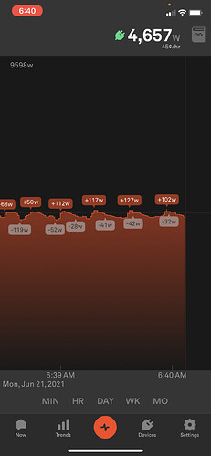

I have a similar problem: every 20 seconds or so, usage is swinging up and down by ~250w. In my case, it’s directly tied to a separate solar battery inverter system that I have powering a second sub-panel in my house (so I’m using the Flex sensor add-on with a 400a split setup). I have a transfer switch and can bypass the inverter, in which case readings are normal. The moment I engage the inverter, I start getting very similar swings. Sense has yet to figure this out (they only just got my Flex CTs reading positive usage!).
I’m a new poster, and I think my account is restricted, as it won’t allow me to upload a picture. But imagine regular, cyclical 250w swings peaking every 18-20 seconds. Suspiciously familiar to your situation with an entirely different setup.
