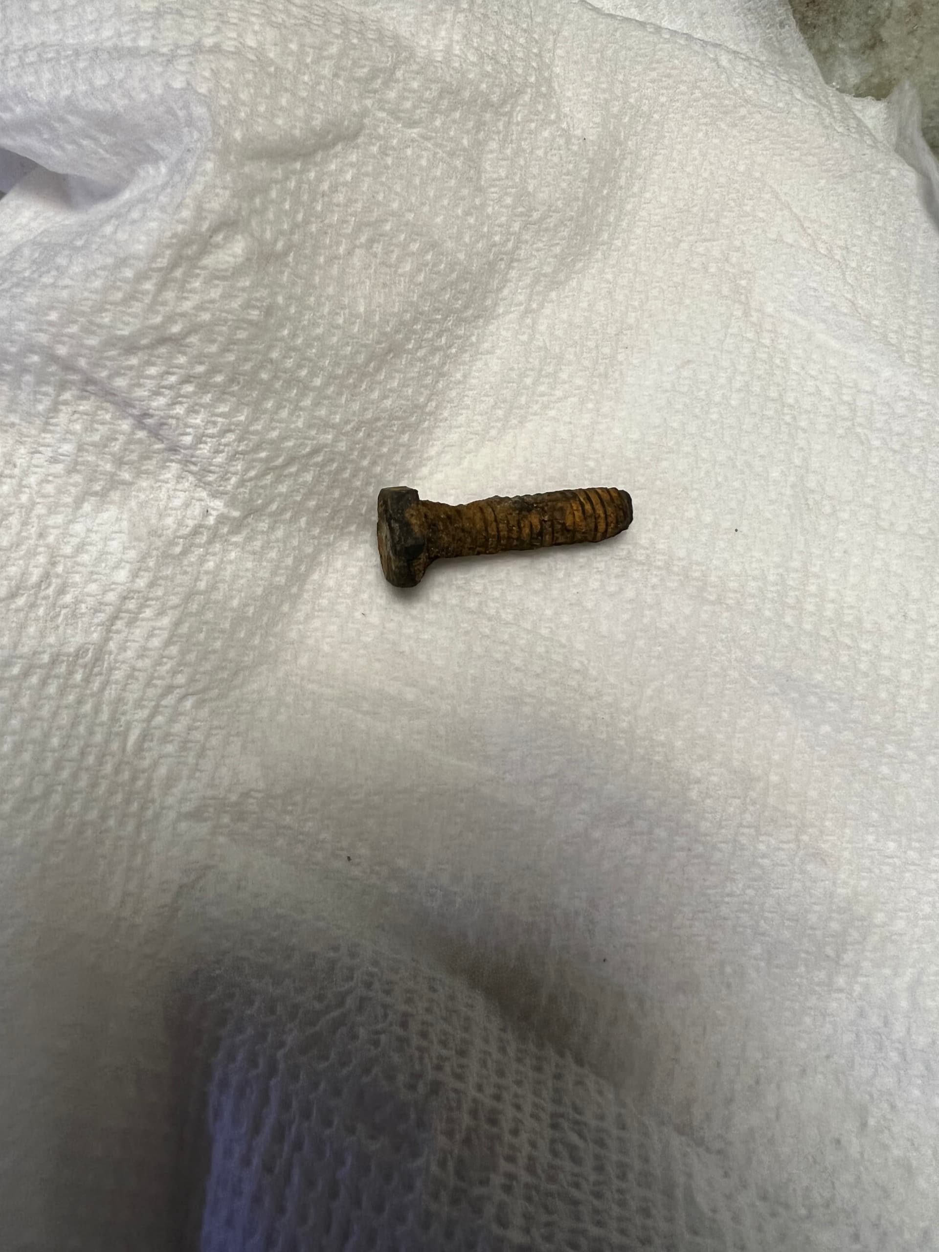

Any guesses? Here’s another hint … this is the culprit that stopped the device, shown above, from working:
That bolt prevented a fan from running?
And it tried for 1 minute to start, back off for 4 minutes and try again ?

Close, but so much worse!
Kevin wins! That bolt was stuck in the impeller of my sump pump. The pump was trying every 4 minutes to start; I’m not sure what made it stop…I can’t imagine there’s a chip in there, so yes, it was probably tripping a thermal switch. But every time it tried, it was eating up 10A.
The pump was submerged (obviously, since it wasn’t pumping out) in about 10 gallons of water, so now I know how long I can go without a functioning sump pump before the water breeches the top of the sump. And because the pump was still sucking electrons, that energy had to go somewhere, so the water was HOT.
