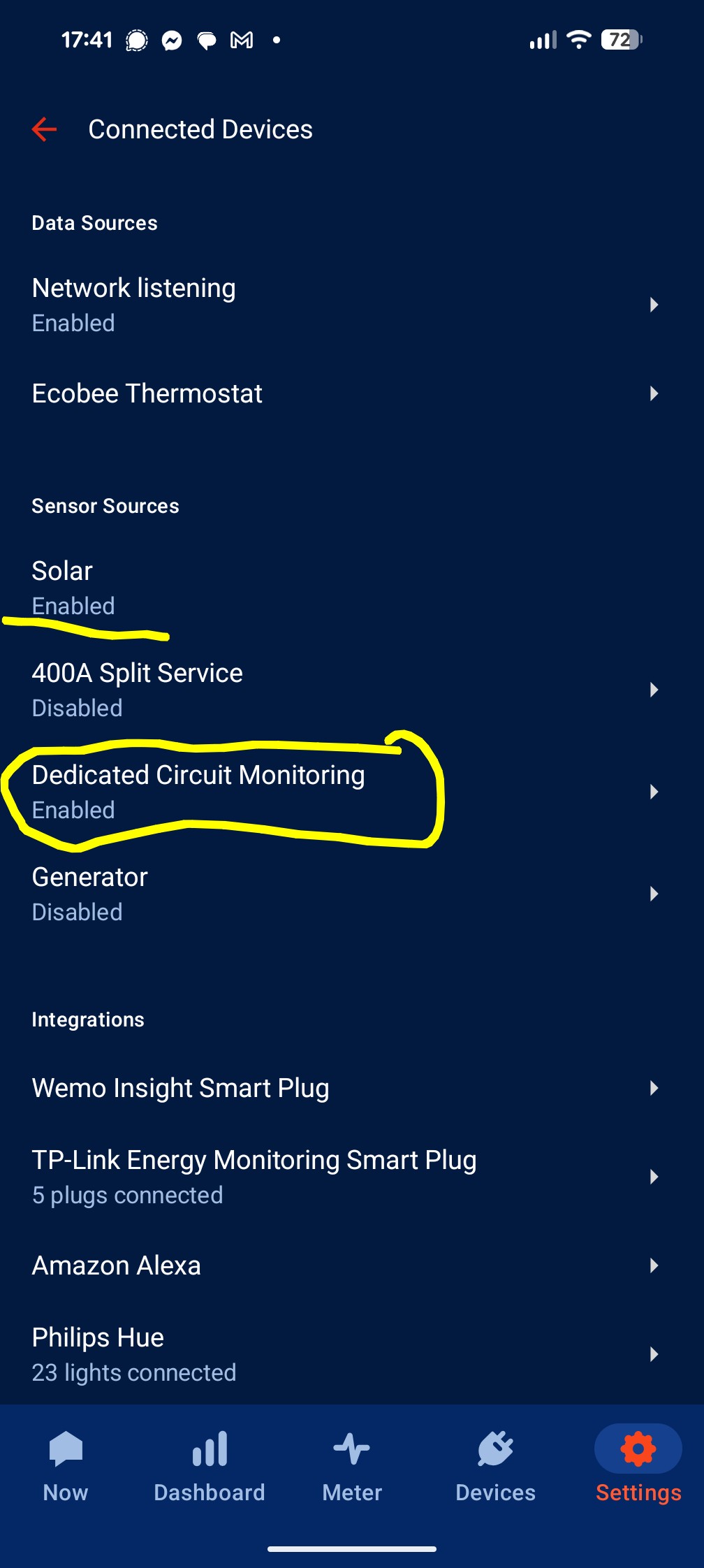

I’ve run into a curious bug. As of less than 2 hours ago, SENSE has “detected” and enabled solar. It’s tracking a purported positive amount of energy being generated.
Only I’ve never had solar. Instead I’ve used that port on the device for dedicated circuit monitoring since it came out.
Was a new firmware just pushed?
Where ever this Phantom solar detection is coming from, it’s not from the dedicated CTs. If I turn both off at the breaker, the “solar” continues being detected. The only thing it could be is an inverse detection of one of the electric baseboards.
When I turn the oven on, instead of the dedicated CT catching the power, it jumps to 60W and the remainder of the 2000ish watts appears as ‘other’.
Screenshots to show this physics defying situation.
Anyone have an idea what might be causing this? Is there a chance that I suddenly have faulty wiring somewhere that just started a couple of hours ago resulting in this “solar detection”?
I’ll update with whatever support comes back with.

Support got back to me. This appears to be an edge-case bug that resulted from the machine-learning enabled solar detection (Detecting solar that isn’t clamped with the Solar CT option set as enabled).
They noted the details and manually disabled the false Solar enablement on my SENSE monitor.
