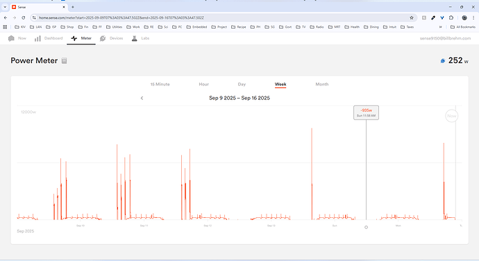

Hi. I’ve been using Sense for years at my house in Tucson. I just added solar to my roof and it’s been on for about a week. The solar was put in after my last visit. I do have the solar CTs but they are not installed. They are locked in a closet in the house and I am away from home until maybe November or worst case July next year.
As you might guess, when my panels are producing, the excess goes out backwards through the main CTs and so I get negative total current and power being drawn. On both the web and phone apps I can see negative power at the cursor. The web app also shows a circle where the graph would be. But it seems that the graph doesn’t want to show negative values on either the web or the phone app. Is there a way to enable this? I’m looking for a temporary fix so I can see at least something while waiting for my chance to get back to Tucson and install the solar CTs.
Thanks!
Here’s what I’m seeing on the web app. The tall spikes are my AC and the short spikes are my fridge but during the day I can’t see them when the solar produces enough to run them.
@sense9150 , nope. No magic switch in the app to show negative energy in the Power Meter or the Detailed Dashboard graphs. But the data is there, so I think you can export an hourly aggregation of it from the Export in the Detailed Dashboard of the web app.
