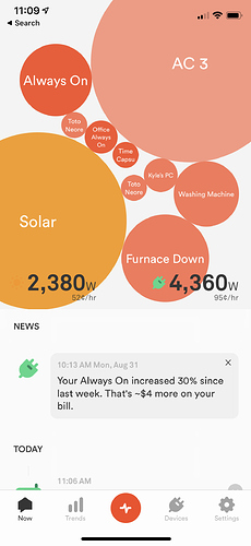

Smart plug devices no longer under "always on"
Hey @pswired. Have you already filed a support ticket for this? I believe you’ve given us permission to view your monitor previously, so I can pass along your information on top of the Support request.

After talking with @JonahAtSense, this is a bug unrelated to the recent fix for smart plugs not nesting under always on. If you are experiencing this issue, please report it to support@sense.com so we can track it and develop a fix.
We made some changes on our end, @pswired. Is your Always On visible again?
Thanks, Justin. I just checked and my always on bubble is back to normal.

As of 10 pm late this evening the 26th my smart plugs disappeared from my always-on.
Always-on shows 45 watts. Should be 136 to 143 area.
The bubbles that are from any of my smart plugs no longer show the the always on wattage, just the current wattage.
