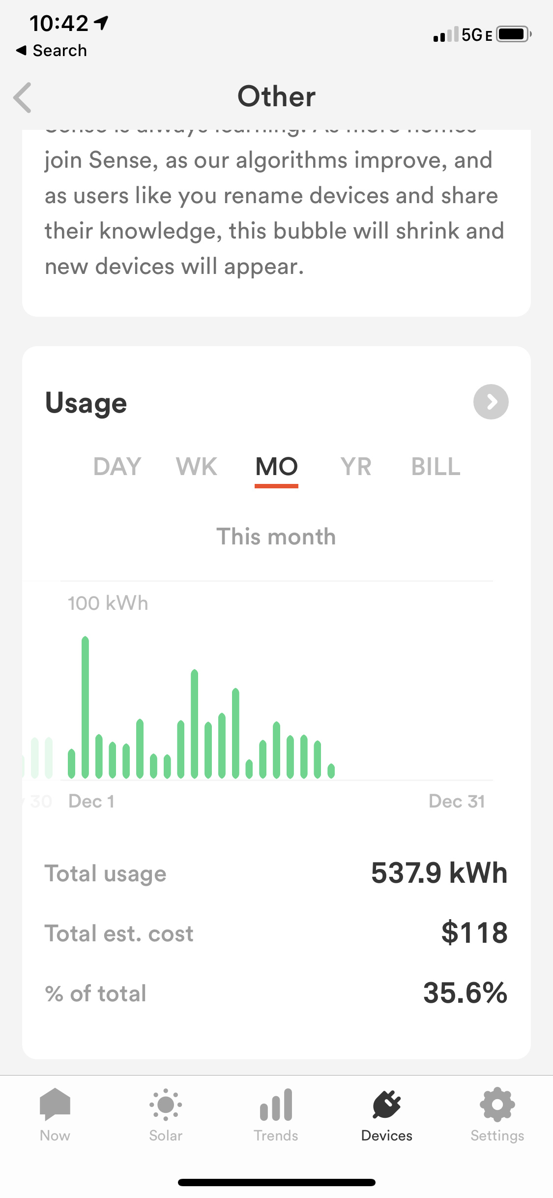

Just want to add that my Other is also missing frequently. Between automatic detection and a ton of smart plugs, I’ve mapped a lot, but I know for a fact other things are running that are not showing up. Hope this helps with the troubleshooting:
(Please ignore the ridiculous heating usage, we’re in the process of installing a new HVAC system and are temporarily using space heaters)
