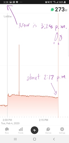

  1. The real-time data was delayed.
    As you can see from picture. When i view the real-time data on 10:57.
    But the graph’s time-stamp show 10:35 !
    I test by turning the light ON-OFF, and yep.
    This is definitely real-time data feed. But the time-stamp was shifted almost 30 min. !
    I try to reset SENSE (Switch breaker OFF and then ON)
    The graph was sync for 5-10 minutes, and getting SHIFT larger and larger.
    Maybe, because of frequency different (60 Hz & 50 Hz) cause timing-error and its getting shift larger and larger ?
    I’ve noticed this symptom will follow with problem #2 as well. (Find below)

I take a look at real-time meter.
And time delay was about an hour ! (cannot scroll right, and the app show blinking real-time data plot from SENSE server.)
Anyway to fix this ?
