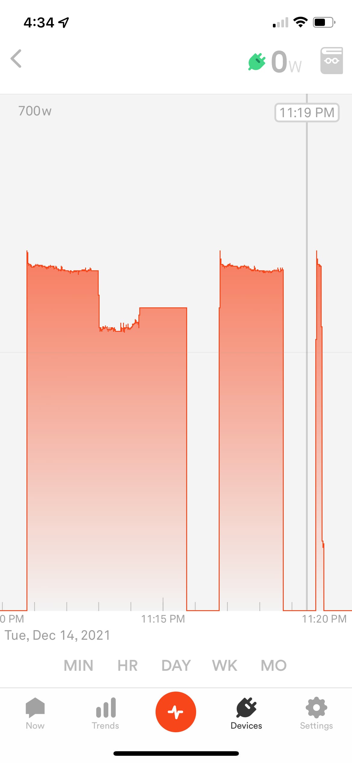

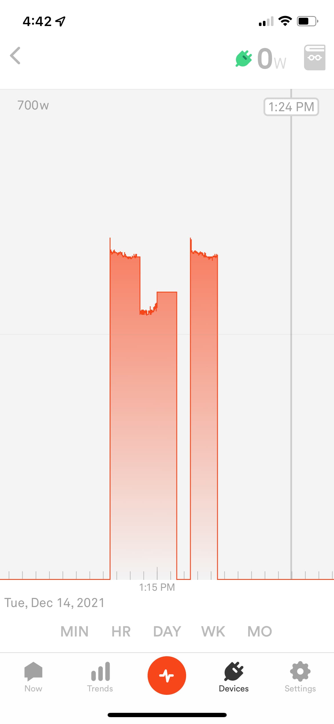

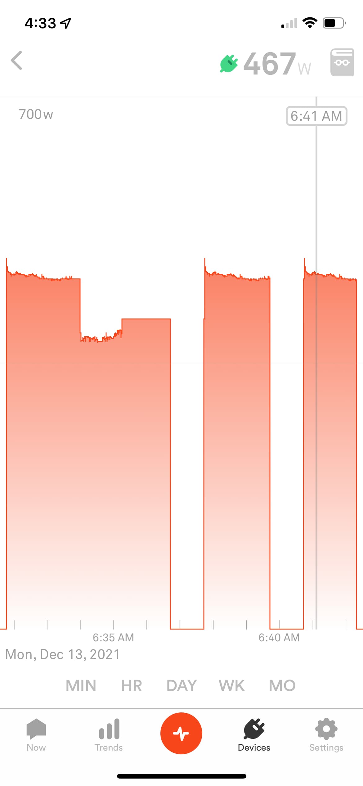

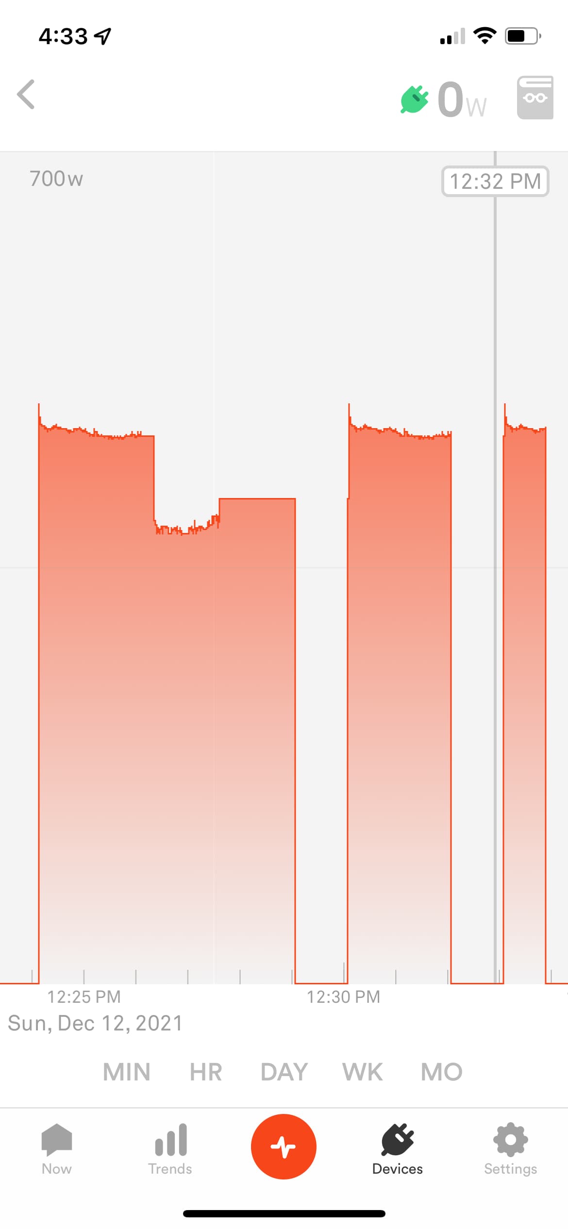

I’m wondering if this could be the device I’m currently trying to track down. It shows up as a heating element. The interesting thing for me (as a brand new user) is the periodicity of it.
Then, it always kicks off with exactly a 488W spike. Most of the time it comes in “threes.” But sometimes it’s “twos” or even a single. See the attached.
We own a JennAir refrigerator, Model W10749399 A.
I’ve attached the waveforms as well. I would be incredibly grateful for any insights into this one.
