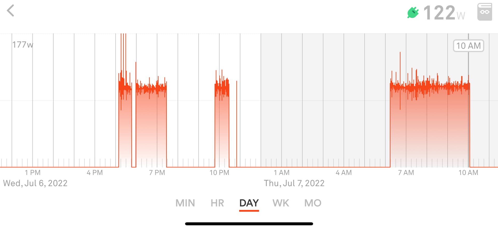

don’t forget about the 100,000+ watt random “glitches” that the wiser outlets report. Nobody seemed to care that the Wiser outlets do that, which can screw up your numbers if you care about that. Some people, including me, have even seen 1,000,000+ watt spikes lol

You inspired me to take a look at my Schneider Wiser 3 Way Switch in my kitchen. The good news it that it has stayed online and reported data for months, mostly spot-on correctly (about 120W for 12 LED bulbs). The bad news its that I still see the 100,000W+ spikes you are talking about. Two views from the Device Power Meter reporting from that Wiser switch.

The challenge is that the Wiser X Series plugs and switches sporadically kick out huge, incorrect measurements that you can see in the charts above. Those false 1MW spikes can throw off usage metrics.
