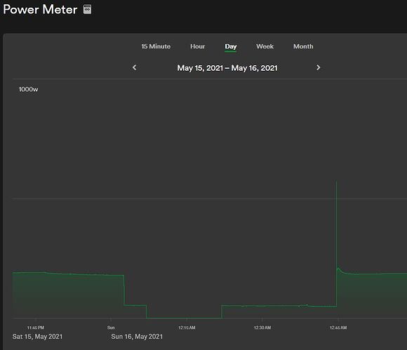

I have not written to Support. Since my original post (including all of those dropoffs) I’d say it’s dropped off seven or eight times. Of those, five have been just after 12am. Although I no longer think it’s a network congestion probem, I do have a new router on order due in about a week. The disconnects seem to happen in waves. I think I went six days without problems, then I had disconnects on Friday, Saturday, and Sunday. It did not disconnect this morning.
The strangest things about my issue are the relatively consistent disconnect time, and the lack of backfilling even for a 15 minute period (on Sunday).
I’ve seen the same thing happen with my Sense, but sometimes it seems to be a problem with the web app rather than a problem with the Sense monitor itself. Just now, I looked at the Sense web app, and got this clearly incorrect graph:

Back to @gpasnak 's first screenshot where it says “Your monitor was offline”, I always see this as well, and I took it to be just a poorly worded version of “we don’t have any data to show for the first hour of the day yet”. Note: this only appears between midnight and 1AM (but ALWAYS between midnight and 1AM). The single-day trends screen (from my experience) only shows data up through the previous full hour (X:00). Since, between midnight and 1AM, there is no previous full hour for the day, there’s nothing to show. The app just tells you that with a maybe slightly concerning message. All other screens (including the power meter) work just fine and show data.
