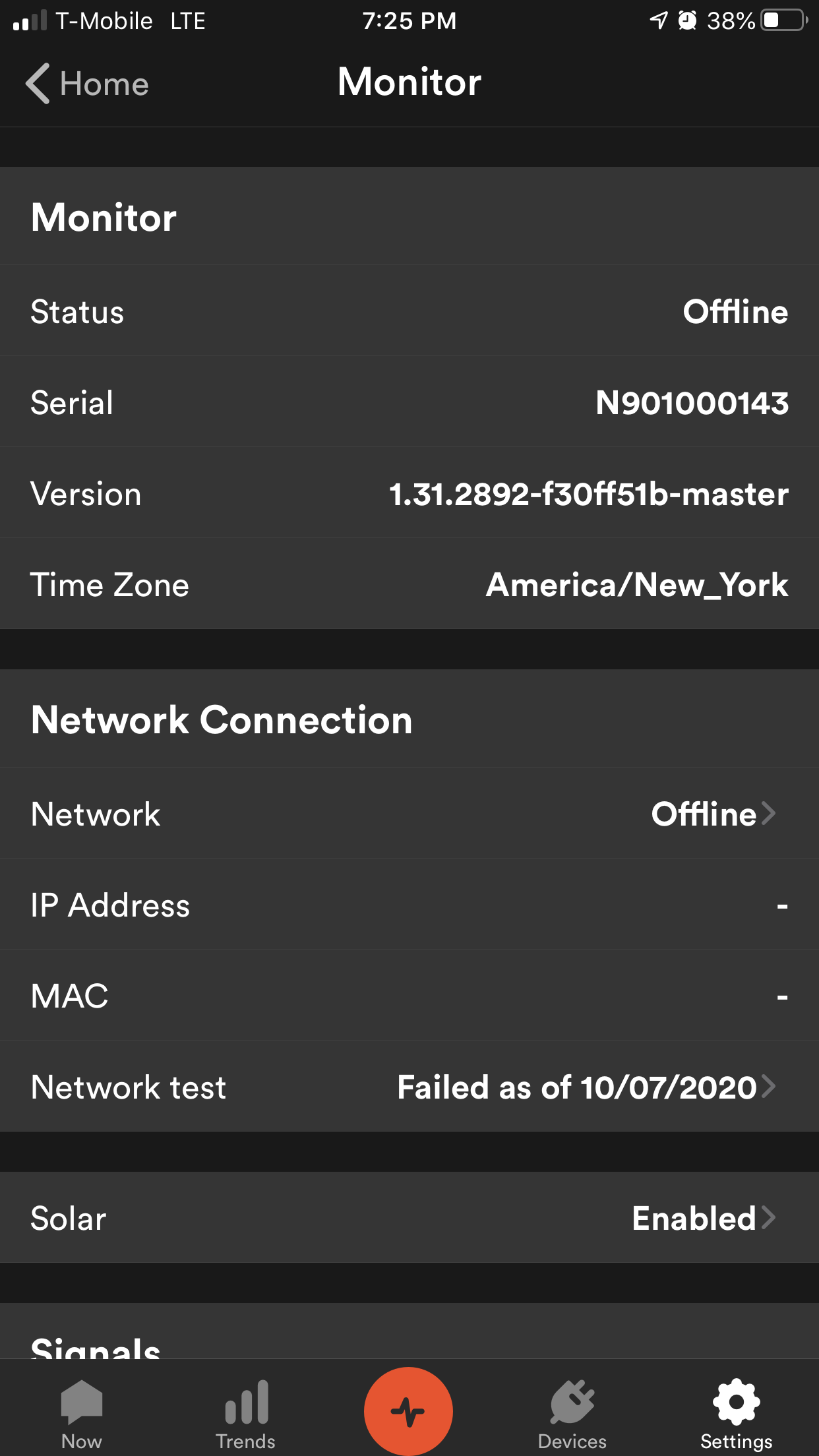

Okay so I was able to remove the HVAC from my smart plug BUT my sense was still acting slow and yesterday I turn off the TP-Link option and wasn’t able to torn it back on. after messing around with this the 16’ extension cable showed up and I was able to get it routed so the antenna was 11’ closer to my home Wi-Fi network. I was actually able to get it to finish a network test and I screen shot the results BUT then decided to put everything back to the way it was so I could do another network test to compare the results and couldn’t get it to finish a network test after this. I tried for an hour and nothing seems to work and I am pretty sure its an issue with the sense meters internal Wi-Fi adapter. I now have it setup like it was before the extension cable showed up and its barely reporting and the bubbles in the app keep going in and out. Not sure what order the pictures will show up in but the one results from the network test that did show up is with the extension cable plugged in and then after that i kept getting test failures and even when it said it wasn’t connected to my network i was able to go into my network app and see that it was showing up on my home network.

When I go into my app for my router it still says that my sense is connected but when i go into the Sense app it says its offline BUT its sill giving me notifications when things are turning on and off and every now and then the bubbles on the app show up.
My Wi-Fi seems to be fine and I can still control my smart plugs in my house without any issues and some of the plugs are further away from my router than my Sense monitor. I also have an original iPad 1 in the garage that I stream TV shows on while I’m out there working and its on the same 2.4GHz channel and my Linksys app says my iPad has a weaker signal than the Sense which is only 7 feet away.
4820 was with the extender on and after I switched the antenna back to the original short extender I couldn’t get my Sense to complete another network test and just kept giving me the can’t talk to sense error and like I said the sense app says my sense network is offline but I’m still getting intermittent updates on the app showing things turning on and off.

I just went out to the garage and put the antenna on the short extension cable that came with the sense monitor and came back inside and now in the sense app it says its connected to my network but I’m still getting this error when I run a network test. I would also like to point out that I am running the network test from my desk in the house and I’m in the same room as my router AND I’m still close enough to the Sense monitor to allow my phone to connect directly to it without having to go to the garage.
So as of this morning it seems as if my Sense is working again like it was yesterday before I ran the network tests so once I get home this afternoon I’m gonna run another network test again without changing anything and see if that is what’s causing my issues which I’m pretty confident it will and as I said before I’m pretty sure it’s the network adapter in the sense that seems to be the issue.
As I suspected I ran a network test and it finished the test and I waited about two hours and tried again and sure enough it tells me it cannot connect to my network again. It seems to be an issue with the sense monitor itself and not my network. I also don’t have issues with anything else in my house connecting to my network and my sense monitor network issues have seemed to have gotten worse over the past year.
